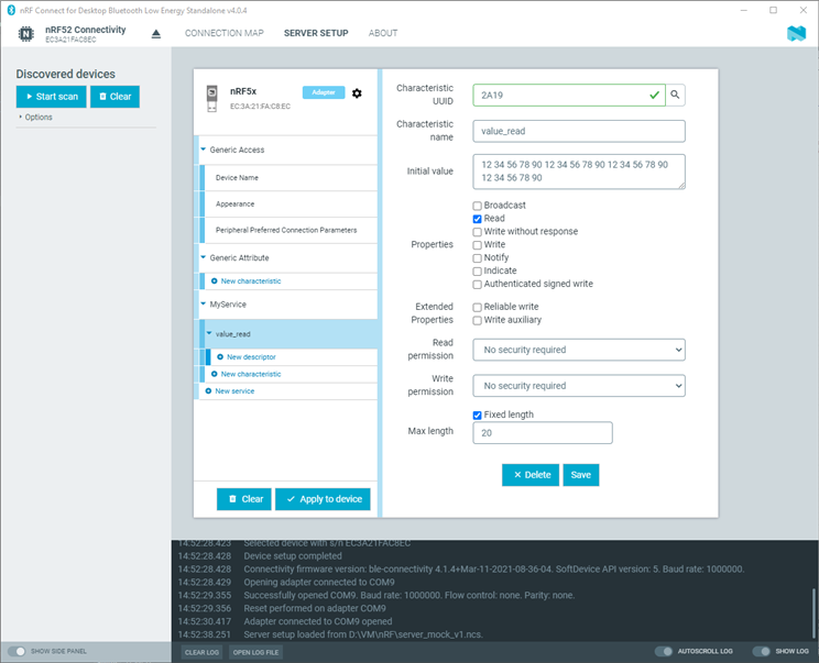

I have a problem in the software ''nRF Connect for Desktop Low Energy Standalone v4.0.4'' with the Server setup.
I use a nRF52840 dongle with the desktop software as a simulated bluetooth device.
In ''Server Setup'', when I create a characteristic  with the Property ''Notify'', I can't apply to the device.
When I use the property ''Read'' , it works.
I miss something ?

    The problem is when I try to ''Apply to device". So I did some tests to explain you where could be the problem.
    - I created a server setup with 1 service which had 1 characteristic with the property "Read" only. (nrf_case_1.png)
          * I can save it and aplied it to the device without problem.
          * on the log file, I had the message "INFO Server setup was applied"
    - I used the same setup and add the "Notify" property to the last characteristic.
          * I could save it without problem.
          * I could save the whole server setup without problem.
          * When I click to "Apply to device", nothing happen. No message on the log file.

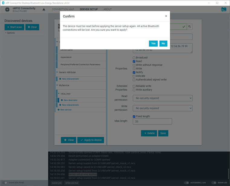

          * Sometimes, but I had a message asking to confirm apply the setup (nrf_case_2.png). The dongle reboot and had lost all setup.
