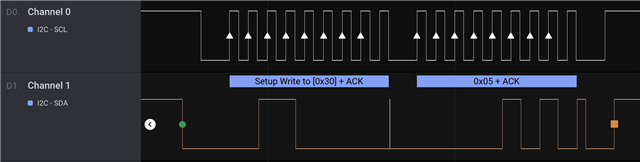

2 I2C Writes are sent instead of 1

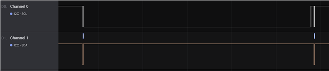

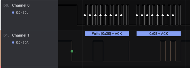

I am using TWI0 for MCP9808 and I notice that a single Write operation causes two Writes (one without a stop condition while the 2nd one with a stop condition)

void Sensor::Write(uint8_t reg, uint8_t size)
    ret_code_t error_code = nrf_drv_twi_tx(&m_twi, SENSOR_ADDR, &reg, size, false);
    APP_ERROR_CHECK(error_code);
    while(!m_xfer_done);	// set by the ISR

   Write(0x5, 1); // send the register address that we'd be interfacing with
