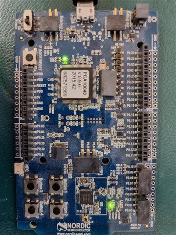

board nrf52832 does not connect anymore
I am following the BLE accademy course and flashing an exercise, the exercise did not perform as requested.
I could not flash anymore.
I clear the board from the switch button and then could not connect the board anymore even I coud see it by the JLINK or nrfConnect or Teraterm.
I tried several version of JLINK without success.
I then made a power ON with the IfBoot pressed and the board now act strangely.
The board led flash every second for a while and is visible on the USB but then flash rapidly and disapear from the USB.
Reading manuals I do not understand what to upload here, what file, how...
Some manual indicate the use of nrfGo which is obsolete... I am completly lost.
Thank you for some hints to start again.

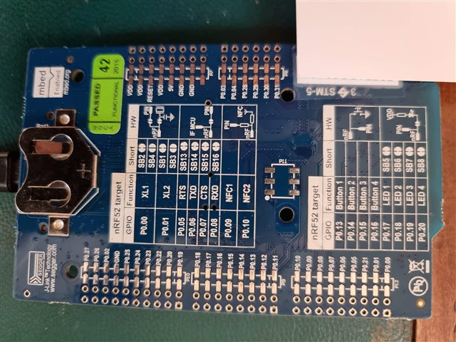

    Holding down this button and powering up will place the nRF52-DK in bootloader mode.
    In this mode, where the X:\BOOTLOADER drive is enumerated, you shall not flash anything other than the jlink binary file, or the cmsis daplink binary.
    Here's a direct link to the jlink recovery binary: https://nsscprodmedia.blob.core.windows.net/prod/software-and-other-downloads/dev-kits/nrf5x-dk-files/j-link-ob-sam3u128-v2-nordicsemi-170724.bin
    Found on this site: https://www.nordicsemi.com/Products/Development-hardware/nRF52-DK/Download?lang=en#infotabs
    If you flashed another file than the jlink/cmsis dap fw while the device is in bootloader state, you can brick the board.
    Does your board enumerate as a usb device at all now?

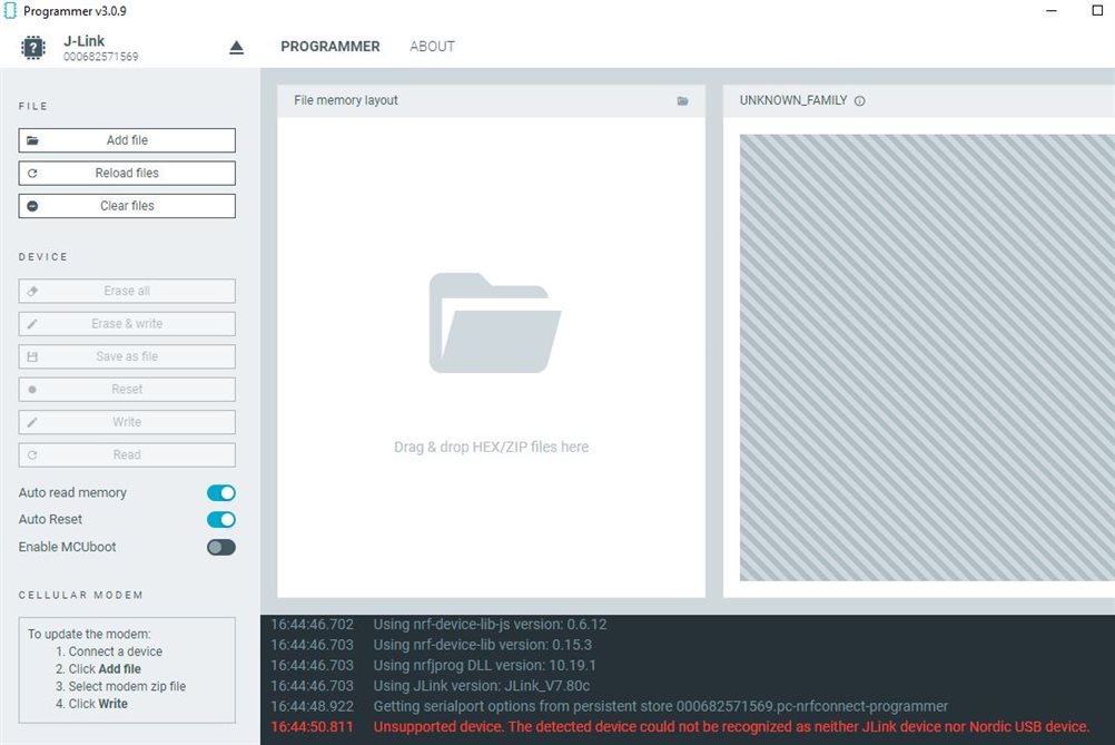

    Now I am back to the original problem :-(
    With nRFConnect I get such messages: "Note: no pre-compiled firmware is available for the selected device."
    or also this message "Unsupported device. The detected device could not be recognized as neither JLink device nor Nordic USB device."
    I can connect thru TeraTerm.
    I can see my board with nRFConnect, but cannot select it.
    With VSCode I cannot see anymore my board connected, which was working before with VSCode
  •  thank you for your precious help.
    --recover failed, here are the error on the vscode terminal:
    [error] [ Worker] - An unknown error.
    [error] [ Client] - Encountered error -21: Command recover executed for 152 milliseconds with result -21
    ERROR: Recover failed. Please make sure that the correct device family is given
    ERROR: and try again.
    Did you call it with the "nrfjprog --recover -f nrf52" option?

    Unfortunately, it shows that there's no successful contact with the nRF-chip at all.
    Could you share a picture of the nRF52-DK board? I just want to check all the switch positions and so forth, in case there's anything there.
    Håkon
    You have an older engineering device, which is reflected by the <v1.0 version of the nRF52-DK. You should use a newer DK, ideally equal to the IC revision that you will go into production with, which is highly likely nRF52832 revision 3.
    Håkon
