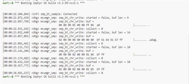

  • Hi Francesco,
    The specification for the SMP commands can be found here: SMP Protocol Specification — Zephyr Project documentation (nRF Connect SDK) (nordicsemi.com).
    As far as I can see, the value from the nRF Connect App for Android that you noted down looks correct.
    A thing to note is that, as noted in the protocol specification, the Sequence Number is supposed to increment with each subsequent command.
    In my tests, I see that it doesn't seem to matter, so it might not explain your setup not working. Nonetheless, please try to increment the Sequence Number appropriately in your future attempts.
    Finally, the Data is a CBOR encoded, and is just empty. The encoding library used in the app simply encodes empty data, {} as a BF FF, with a Data Length of 2. You can keep it as is.
    So, the command you will want is:
    02-00-00-02-00-00-<Sequence Number>-05-BF-FF
    I am not familiar with the react-native-ble-plx library. If you really want someone to join you looking into it, I can. As of right now, I can only make these suggestions:
    • Please see if it is possible to enable logging to see what the library tries to send to the device.
    • Please check if the byte order is handled differently in that library.
      • For a quick test, you can try to get it to talk with the Nordic UART Service instead. This service handles notifications as ASCII strings.
    For the device end, you can configure the following Kconfig to get logging from the BLE Transport of the SMP module:
    CONFIG_MCUMGR_TRANSPORT_LOG_LEVEL_DBG=y
    CONFIG_LOG_MAX_LEVEL=4
    # Need immediate logging or the device will reset
    # before the hex dump of the command is printed
    # For debugging purpose only
    CONFIG_LOG_MODE_IMMEDIATE=y
    # Set SMP Transport work queue stack size unreasonably large
    # to prevent stack overflow due to immediate logging
    CONFIG_MCUMGR_TRANSPORT_WORKQUEUE_STACK_SIZE=8192
    # Optionally switching logging backend to UART
    CONFIG_LOG_BACKEND_RTT=n
    CONFIG_LOG_BACKEND_UART=y
    With that, I was able to log that the device reset at the same command you found:
