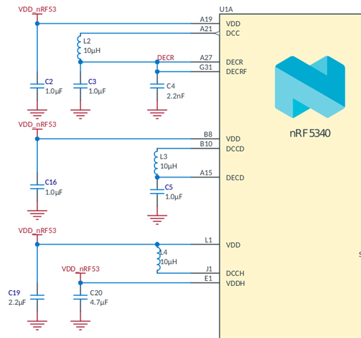

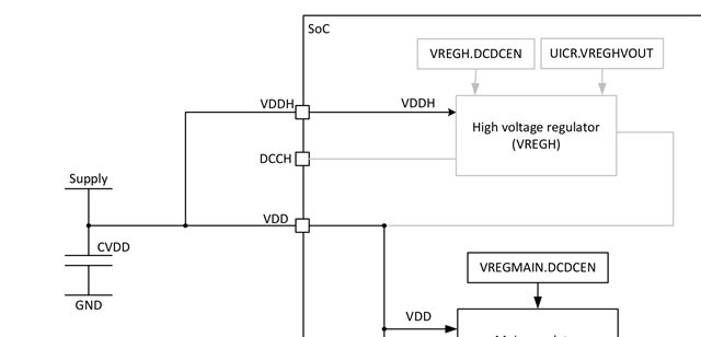

nrf5340 in the nrf7002 DK is supplyed in normal mode but seems to have a high voltage schematic
from documentation, in normal mode the nrf5340 does not need a self in dcch pin, and VDDH is connected to VDD.
But in the the nrf7002 dk the schema is:
Here VDD is connected to VDDH, but why there is a self connected to DCCH ? knowing that VDD_nR53 is 1.8V.
