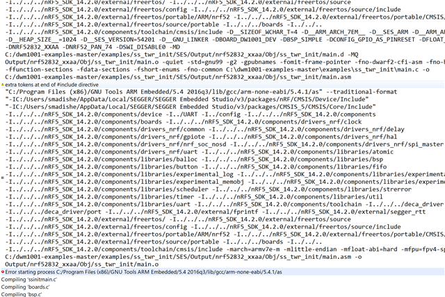

Error starting process C:/Program Files/SEGGER/SEGGER Embedded Studio for ARM 7.20/gcc/arm-none-eabi/bin/cc1
 I have tried building the nrf example projects and they build fine. But this project gives this error.
The version I am using is SEGGER Embedded Studio for ARM
Release 7.20 Build 2023050901.53220
Windows x64
I have tried comparing the settings with the project that is building as suggested in older ticket but I couldn't find any difference. Anything specific I need to check?

    I'm afraid that Nordic doesn't have anything really to do with the Decawave software solution, but from what I can tell, The v5.42a version of SEGGER should still work with SDK v14.2.0 solutions. The GNU toolchain I'm using on my end is Arm GNU Toolchain arm-none-eabi\13.2 Rel1 and I'm able to build SES projects both 17.2.0 and 14.2.0 just fine. I see in your build log that you're still running off SES 5.70, and a very old GNU toolchain version which seems like a mismatch.
    Have you tried reaching out to Decawave for information on what they recommend now that the suggested SES version no longer is available from SEGGER's pages.
