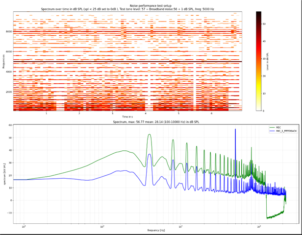

After some more investigation, it seems that this is caused by the onboard RGB leds pulsing during measurement (which is done with a 400Hz PWM signal, as seen on TP 37/38/39).
The noise at 400Hz pulsates with the LEDs fade, peaking during the fade's 50% point.

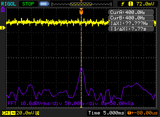

I tried to find the root cause, but it actually is hard to measure the noise on the output itself.
It is visible on some points on the PPK2 itself, e.g. the VREF_IA.

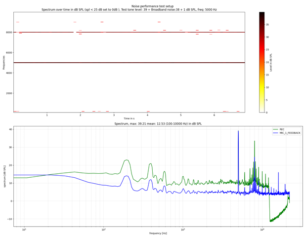

However, a quick test showed that the noise disappeared when the RGB LED is disconnected (cutting through TP 37/38/39, which cuts the trace from the LED control MOSFET to the LED itself).

voltage on VREF_IA:

measurement on our custom device audio path, unmodified PPK2:
meaurement on our custom device audio path, PPK2 with LED traces cut:
note: there seems to be yet another noise at 200 Hz, but that is affecting our measurement much less, since the harmonics do not reach the 5kHz test tone, and another component which seems to be related to USB (carrier always visible at 8kHz, spectrum widening with data transfer)
