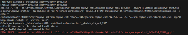

Adding another I2C node causes undefined reference to `__device_dts_ord_XXX'
Hello!
I am trying to merge two simple Zephyr applications that both use I2C. I have an application that uses the SBC_OLED01 display. I followed these instructions. The second application uses the LISH3DH accelerometer with the nordic example LIS2DH. Both are using the i2c0 node. When I compile them separately it works fine, but after I merge them I get the error undefined reference to `__device_dts_ord_XXX'. I have searched the devzone but have not found anything that could help me. I assume the error lies in the overlay file. Here is the overlay file:

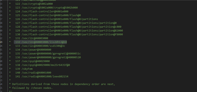

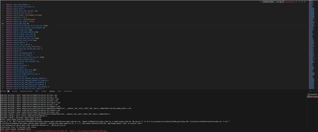

    I get the following error message:
    The ordinal number 132 in the device_generated.h corresponds to lisdh12:
    This means that the Python script does not generate the part of the code corresponding to lisdh12. A look at the prj.conf file shows that the LISDH sensor is set as follows:
    However, looking into the autoconf.h file, the macro is not generated:
    I do not know why is this the case, because I did set the flags in the prj.conf files. In the documentation it says  it only needs/depends on (I2C || SPI) && SENSOR.

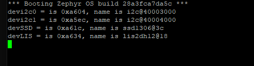

    In the main, I can access both I2C controllers like this:
    const struct device *devi2c0 = DEVICE_DT_GET(DT_NODELABEL(i2c0));
    const struct device *devi2c1 = DEVICE_DT_GET(DT_NODELABEL(i2c1));
    printk("devi2c0 = is %p, name is %s\n", devi2c0, devi2c0->name);
    printk("devi2c1 = is %p, name is %s\n", devi2c1, devi2c1->name);
    I can also access the LIS2DH12 sensor by using DEVICE_DT_GET_ONE() macro
    const struct device *devlis = DEVICE_DT_GET_ONE(st_lis2dh12);
    printk("devLIS = is %p, name is %s\n", devlis, devlis->name);

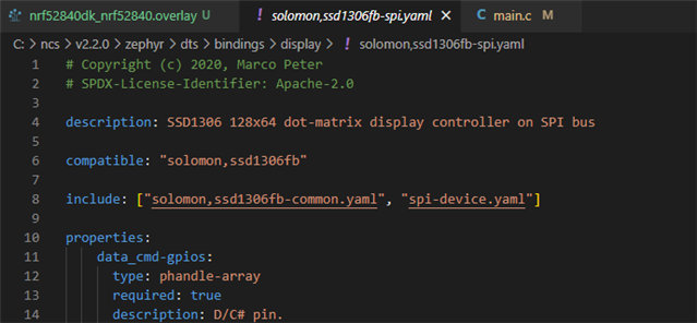

    However, this will not work for the SOLOMON device.
    The reason is that the solomon,ssd1306fb is a spi device with spi.yaml bindings
    Project is attached for reference. Regards, Naeem

    Strange!!! I got it working on my nrf52840 board with the SOLOMON device.
    case314823.zip

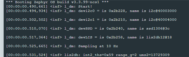

    Cool!!! I took your project and made it work for both thessd1306 and lis2dh12. Below is the console output and the project.
    Project:
    case314823_2.zip
    Maybe, you can help me to understand why is this now working? I am also quite new to the Zephyr ecosystem.
    As for my problem in my project, I found the "solution" after seeing and reading this Github post:
    "When I set I2C to y in my driver kconfig, my project was surprisingly compiled and passed, and there will be no previous problems."
    So I did the same and the project compiled confusingly. I had a Kconfig that I updated as follows:

    Now I have gone through your project and the link which you have posted.
    So basically, the screen (device) from solomon supports both the i2c and the spi interface.
    But previously we were configuring it wrong in the overlay.
    Now you have removed that part from the overlay, and I see that you were using "SHIELD=ssd..." parameter in building, and thats solomon device gets correctly configured in the DTS.
    When I modify the overlay based on the ssd-shield overlay, and I add config for this device (and its dependency) [CONFIG_SSD1306 and CONFIG_DISPLAY], then it is working good.
    So I think previously our overlay was not good, and also we need to enable driver for this device in the config.
