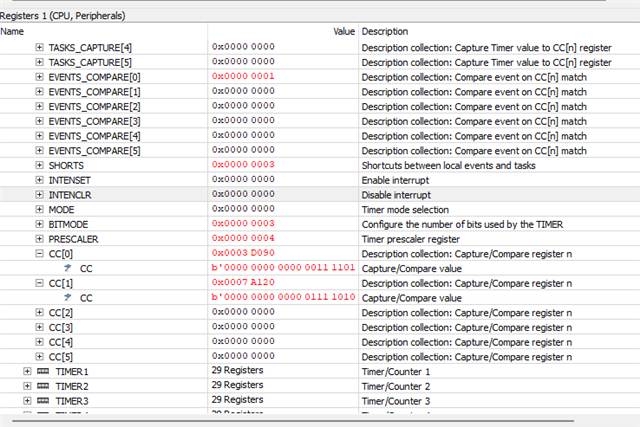

I am trying to use two channels on one timer0, to handle two gpiote tasks to toggle two on-board leds on nRF52840 DK. I am using two ppi channels to handle this.
I have set the timer0_ticks0 and timer0_ticks1 as 250ms and 500ms and used extended compare on both the channels to generate a compare events accordingly.
I could see from the EVENTS_COMPARE[n] register, that only EVENTS_COMPARE[0] is triggered and not the other.
Diggging into it a little bit shown that only the lowest value from CC[n] gets a compare event.
Please find the code here. Any clarification on this is highly appreciated.
KInd regards

    The 'NRF_TIMER_SHORT_COMPARE0_CLEAR_MASK' flag will cause the TIMER counter register to be cleared after you get the COMPARE0 event, see register description for the TIMER.SHORTS register. As a result, the counter will never reach COMPARE1 value.
    Vidar

    Is the COMPARE0 period always going to be equal to half the COMPARE1 period? If so, you can use the PPI fork feature to have the COMPARE1 event also trigger the first endpoint.

  • Hi Vidar,
    thanks for your reply. II have selected those Periods just as PoC to understand if different channels from a timer could be used to get event triggers.
    It was quite informtive to see that task2 could be forked to be trigegred when the task1 is triggered by the event1 with ppi. Perhaps I can think of utilizing this feature.
    Perhaps for now we can close this ticket. I will do my pwm measure implementation and will create a new ticket if I have any bottlenecks.
    Thanks for your support.
