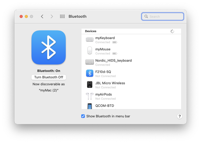

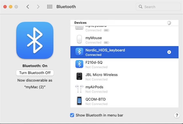

Hi team, by following the guide Bluetooth: Peripheral HIDS keyboard I was able to install the sample on the nRF52840DK and both my iPhone and Mac recognize the board acting as a Keyboard.
I'm able to pair the board and Led2 is turned ON as it should indicating one device is connected.
So far so good, the problem is that nothing happens when Button 1 is pressed (meaning no text is received in the text editor running on the Mac),

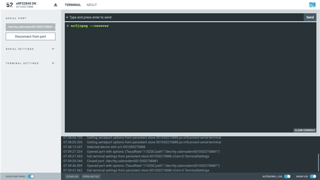

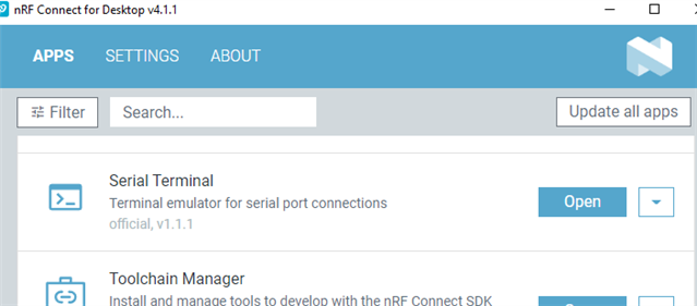

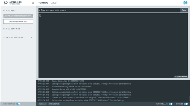

    3) Do you have any log output from the DK?
    Not really but since I'm pretty new to this development environment maybe it is because I don't know how to collect it...
    I have tried to pair with an Android 11 device and I get a "Couldn't pair" error message even though the MAC address is being shown
    Many thanks for your reply, looking forward for any hints,
    Regards, Simon

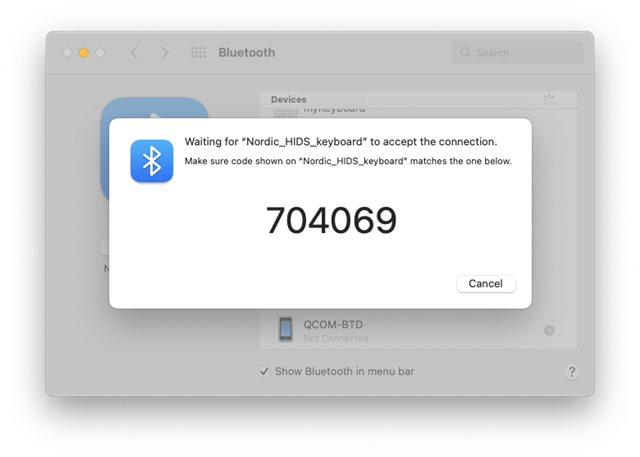

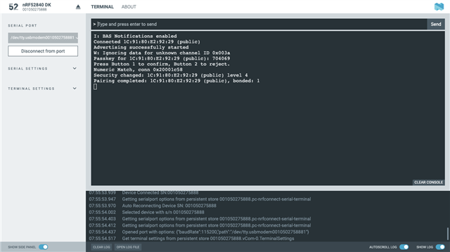

    I tested this on a Macbook. Using nRF Connect SDK v2.4.0.
    1) I flashed the sample, without any modification to a nRF52840-DK.
    2) I pressed button 4 on the DK, in order to start advertising.

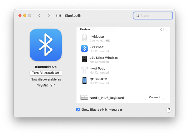

    3) On the MAC, go to System Preferences -> Bluetooth. The device should appear as "Nordic_HIDS_keyboard".
    4) Press Pair/Connect. In the terminal(UART logging from the DK), a passkey will be printed.
    5) Enter the passkey on the MAC, and it should pair successfully.
    6 ) Go into a text field, e.g. a text editor, and press button 1 on the DK. It sends one character of the predefined input ("hello\n") to the Mac.

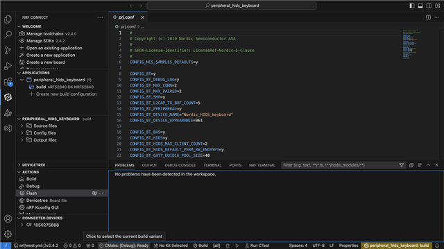

    I'm using nRF Connect SDK v2.4.2
    same

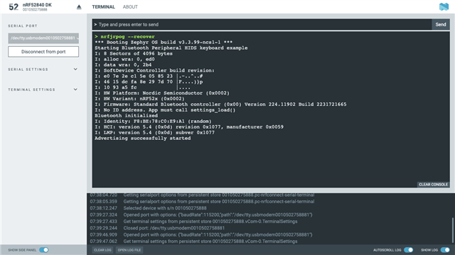

    Pressing button 4 nothing happens, after turning the board OFF and ON it starts advertising.
    It does
    I Pair using the instructions as they appear on the guide
    "Button 1
    When pairing, press this button to confirm the passkey value that is printed on the COM listener to pair with the other device."
    I never enter this following step since the device is already paired. As a matter of fact I don't even know what are you referring to with UART logging from the DK
    I don't need to do this as the board is already paired and seen by the MAC
    nothing happens
