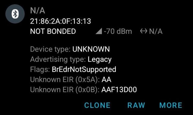

I'm currently working with the nRF52832 DK and using the nRF Connect SDK v2.4.2. My goal is to send custom data in non-connectable advertising mode, and I specifically want to set my own Extended Inquiry Response (EIR) data. I would like to include variables or a custom device name in this EIR data. Can someone provide guidance on how to achieve this using the nRF Connect SDK v2.4.2?

  • Hi Hari,
    Is that a nRF52832 application broadcasting the advertisement that you screenshot? EIR and Inquiry is a Bluetooth Classic concept, and I don't believe the nRF52832 is capable of that.
    If you want custom data in non-connectable advertising mode, then you will want to use the Manufacturer Data type. I am not familiar with the Inquiry concept in Bluetooth Classic.
    In Bluetooth Low Energy, there is the concept of Scan Response. A scanner that is performing active scanning can get a Scan Response from the advertiser. Note that a scanner that is performing passive scanning will not get this Scan Response.
    You can find
    - The Zephyr RTOS Bluetooth: Beacon sample shows the use of Scan Response
    -  as well as custom Device Name, and the Zephyr RTOS Bluetooth: iBeacon sample shows the use of Manufacturer Data.
    For more information about Bluetooth Low Energy advertising, please refer to our webminar on the topic:  Where can I find the presentation used in the "Everything you need to know about Bluetooth Low Energy advertising Webinar"? .
    Shortened Device Name and Complete Device Name are also BLE advertising data types that might serve your purpose. For more information, please refer to the documentation and the Bluetooth Core Specification Supplement.

  • Is that a nRF52832 application broadcasting the advertisement that you screenshot? EIR and Inquiry is a Bluetooth Classic concept, and I don't believe the nRF52832 is capable of that.
    Yes,I am using nrf52832dk
    but i am getting the results like this
    #define CUSTOMDATA   0X5A
    #define USERDATA     0X0B
    static const struct bt_data ad[] = {
         BT_DATA(CUSTOMDATA, &switch_status, 1),
         BT_DATA(USERDATA, Target_Address,  ARRAY_SIZE(Target_Address)),
    I don't want to use scan response.
    i want my data in advertisement payload only with custom heading instead of (UNKNOWN EIR).

  • Hi Hari,
    That is not accurate usage of the BT_DATA helper macro. I believe you also are misunderstanding how BLE Advertising work.
    Please refer to its documentation and the Advertisement webminar I linked previously.

  • I understand that my previous statement may not have been entirely accurate.
    However, I would like to clarify my intentions. Is there a way for me to access a specific part(EIR)? If there is a possible method to do so, it would be greatly appreciated.
    I don't understand this question.
    Like I said before, EIR is a Bluetooth Classic concept. It is not available on the nRF52 series SoCs, at least for now.
    In a BLE Advertising, there can be multiple data fields in both the main Advertising packet, and in the Scan Response packet. However, almost all of them have specifications that they must comply with, restricting the kind of data you can put in. The data type that provides the most customizability is Manufacturer Specific Data.
