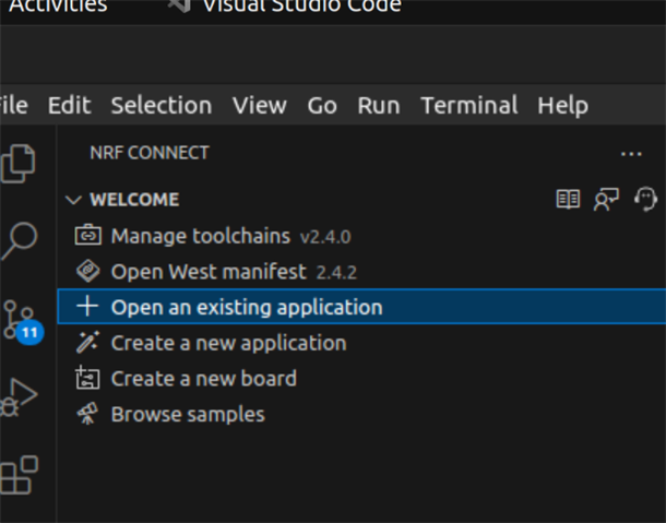

    The method I was using to create an application from a sample was to do
    Create a new application > Copy a sample > (selecting relevant sample application)
    Using this method populates the application directory with git tracking files.
    Presumably there is a rationale for this, but as a casual git user it was more challenge than convenience! Please double check with the dev team to ensure this is serving some other helpful purpose. I would contend that my method is what the software "guides" you to do.

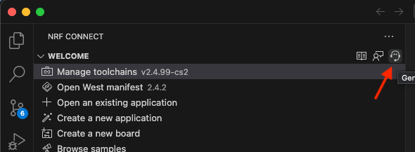

  • I do not get a .git folder in the application I create with the approach you describe, and that should not be the case. Can you double check?
    If you are able to reproduce, can you generate support information (that has details on versions etc) as shown here and upload to this case?
  • Hi Einar, it is reproduceable for me. The two projects I created to test are machine-learning and peripheral-hids-mouse
    Here's my info and the generated git files.

    I seems I did not test the most recent version the last time, I see the same as you now. A git repo is automatically created when you make a new application. We have received feedback that this may not be desirable and are looking into it, but for now, it is not configurable. So at this point, the simplest is probably to delete the .git folder and .gitignore file after creating the application if you do not want it.
