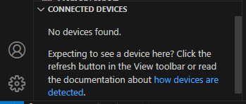

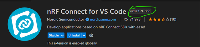

I updated to the latest nRF Connect for VS Code extension version - v2023.9.336 and noticed that "CONNECTED DEVICES" is always empty. Refresh/restart - no help. Devices that used to show there, are now gone (for ex. nRF52840 DK).

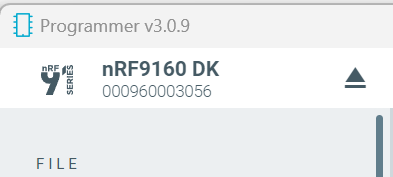

Everything shows Ok in the nRF Programmer.
I reverted back to version v2023.7.129 and "CONNECTED DEVICES" started working again.
Is there something special that needs to be configured with the latest version of the extension? Or is this a bug?

    Programmer, v4.0.1 lists the devices properly.
