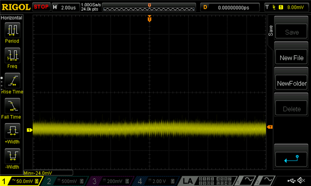

Attempting to use ADC to read the VDD_GPIO pin voltage.
We want to read the GPIO voltage level. Per the documentation this should be possible by using input 9 and the internal reference. What I am observing is that probing the pin with a multimeter reads 1.78 V. The ADC is giving me 1.68 - 1.72V. I've tweaked several of the configurations and this is the best I am getting.
Is there any special considerations for reading the GPI voltage this way?
