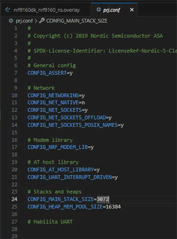

  • Hello Torbjørn,
    Thank you for your response and recommendations. I have tried configuring UART1 for communication with the ESP chip and maintaining UART0 for other matters. However, I am experiencing some problems with the AT commands; it does not communicate correctly unless it is with uart0 and the extender pins.
    I made the following configurations in the nrf9160dk_nrf9160_ns.overlay file to set the UART1 pins and to set it as default in the at-host, but still, when I send AT commands, I only receive empty strings in response.

        chosen {
            ncs,at-host-uart = &uart1;
    Is there something obvious that I might be overlooking? Or is there something else I should check or configure to make UART1 work for AT communication?
    Any additional help would be greatly appreciated.
    Warm regards, Carlos
