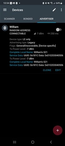

  • Hi Karl,
    Thanks for getting back to me, i have used the nrf connect app on my phone as an advertiser, here is the settings i used.
    Yes i commented out the call to bt_data_parse as i had added this in an attempt to get the manufacturing data. I then commented this out when it didnt work for me
    is there a way that is generally used to get the maufacturing data from a scan? or does this require a different function?
    William
