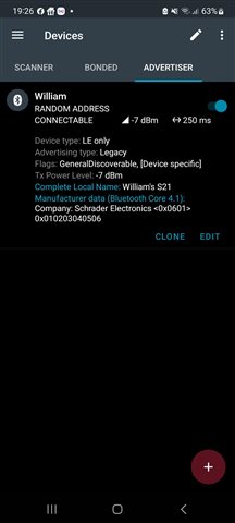

    thank you for your reply, i see, i had changed from manufacturing data to service data to see if it would give me the correct result for either as i originally was not getting the manufacturing data, i have tried this again and dont appear to be getting the correct data again. I do get the advertisers name: William's S21.
    Output from Observer:
    [DEVICE]: 45:05:A2:91:78:16 (random), AD evt type 0, Tx Pwr: 127, RSSI -81 Data status: 0, AD data len: 31 Name: William's S21 C:1 S:1 D:0 SR:0 E:0 Pri PHY: LE 1M, Sec PHY: No packets, Interval: 0x0000 (0 ms), SID: 255, buf data 536901229
    Advertiser setup:
    I am using the same code for this aswell.
