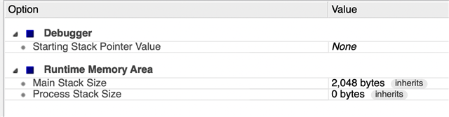

  • The stack size is 2048 bytes, yes?
    I filled it in with 0xAA and I still see 0xAA during runtime (doesn't get overwritten) so probably no stack overflow.
    #define STACK_PATTERN 0xAA  // Use the byte pattern 0xAA for the stack initialization
    #define STACK_SIZE    2048  // Assuming a stack size of 2048 bytes for demonstration
    #define STACK_LIMIT   128   // The limit in bytes that we don't want the stack to approach
    uint8_t stack[STACK_SIZE];
    void initializeStackWithPattern()
        for (int i = 0; i < STACK_SIZE; i++) {
            stack[i] = STACK_PATTERN;

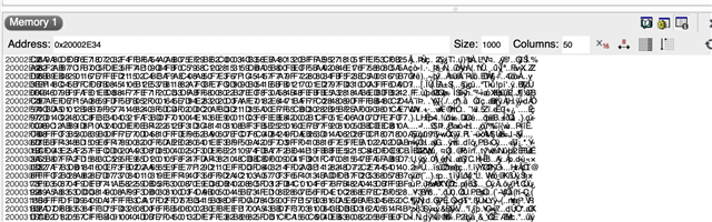

    Anyways, there's one task named "Process" but here, buff contains "Pro". Do you see why it could be?
    extern "C"
        void vApplicationStackOverflowHook( TaskHandle_t xTask, signed char *pcTaskName )
            ( void ) pcTaskName;
            ( void ) xTask;
            char buff[100] = {0};
            strncpy(buff, (const char *)pcTaskName, sizeof(buff) - 1); // buff = "Pro"
            UBaseType_t uxHighWaterMark = uxTaskGetStackHighWaterMark(NULL);
            while(1);
  • maybe do a strncpy like below instead
    strncpy(buff, (const char *)pcTaskName, configMAX_TASK_NAME_LEN);
    Or check in the memory if there is only Pro in the sequential address of the memory of if it has the whole "Process" name and it is just the matter of using the right size in the API.
  • Copying configMAX_TASK_NAME_LEN bytes still produces Pro.
    What memory view would you look into?
    No way anyone can decode this
  • The problem was configMAX_TASK_NAME_LEN inFreeRTOSConfig.h was set to 4.
