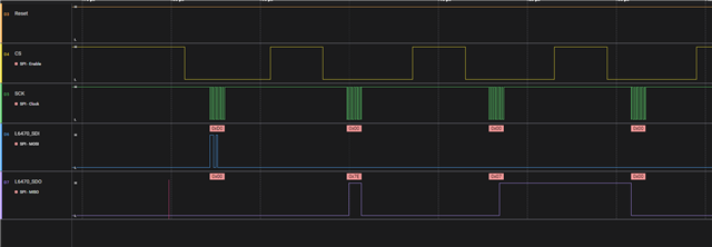

If a status messages is sent to the L6470, the device should send a response back of 0x7E07.  On a different design, I have a STM32F4 communicating with a L6470,  When the STM32F4 issues the status request, the L6470 responds with 0x7E07.

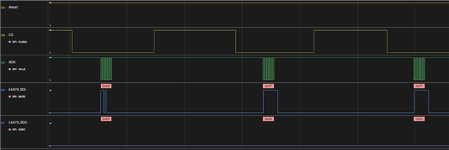

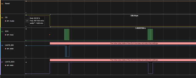

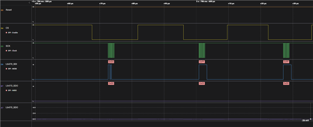

When I am using the code on the nRF52832 trying to get the status from the L6470, I don't see anything on the SDO back from the device when the device sending in the clock pulses.
I am hoping anyone might have some suggestions.
I did modify the code somewhat so I could use some other SPI code that I found.  With code, I did see some form of communication back on the SDO line but it was incorrect.  So I believe I have the board hooked up correct but I am not sure what I have wrong.
Attached is the modified code.  You can use the #define of L6470_CODE to try the one way or the #MY_CODE for the other.
