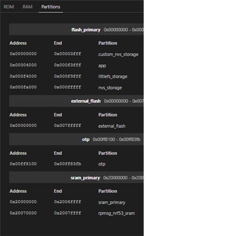

    2. Can you provide the memory map, i.e use VS Code extensions tool or navigate to the build folder and report back what "ninja partition_manager_report' generates?
    3. If you have a static_pm.yml for each of the cases, can you provide that as well?
    Andreas

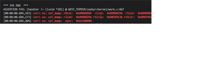

  • 1. Here is a screenshot of a kernel fatal error.
    2. Here is a screenshot of a memory map
    3. Here is a pm_static.yml file for each case
    What is posted beneath here? What is posted above the line? I need the entire log to be able to cipher anything from it. Please upload it as a text or insert code
    This image is also cut off, can you reupload a full picture including all numbers

  • Hello, I apologize for the truncated image. Here is the textual representation of the kernel error:
    ASSERTION FAIL [handler != ((void *)0)] @ WEST_TOPDIR/zephyr/kernel/work.c:667
    [00:00:00.807,373] <err> os: esf_dump: r0/a1:  0x00000004  r1/a2:  0x0000029b  r2/a3:  0x00000024
    [00:00:00.807,403] <err> os: esf_dump: r3/a4:  0x0000029b r12/ip:  0xb6a93df4 r14/lr:  0x000351a7
    [00:00:00.807,434] <err> os: esf_dump:  xpsr:  0x61100000
    [00:00:00.807,495] <err> os: esf_dump: s[ 0]:  0x00000000  s[ 1]:  0x00000000  s[ 2]:  0x00000000  s[ 3]:  0x00000000
    [00:00:00.807,525] <err> os: esf_dump: s[ 4]:  0x00000000  s[ 5]:  0x00000000  s[ 6]:  0x00000000  s[ 7]:  0x00000000
    [00:00:00.807,556] <err> os: esf_dump: s[ 8]:  0x00000000  s[ 9]:  0x00000000  s[10]:  0x00000000  s[11]:  0x00000000
    [00:00:00.252,716] <dbg> nrf5340dk_nrf5340_cpuapp: remoteproc_mgr_boot: Network MCU released.
    [00:00:00.807,617] <err> os: esf_dump: s[12]:  0x00000000  s[13]:  0x00000000  s[14]:  0x00000000  s[15]:  0x00000000
    [00:00:00.807,647] <err> os: esf_dump: fpscr:  0x00000000
    [00:00:00.807,678] <err> os: esf_dump: Faulting instruction address (r15/pc): 0x0003cce8
    [00:00os: z_fatal_error: >>> ZEPHYR FATAL ERROR 4: Kernel panic on CPU 0
    [00:00:00.807,769] <err> os: z_fatal_error: Current thread: 0x20001ed8 (unknown)
    [00:00:00.975,769] <err> os: k_sys_fatal_error_handler: Halting system
    During my investigation into the issue, I managed to find a way to run the project without encountering the kernel error. This involved disabling the CONFIG_BT_SETTINGS. The documentation regarding this config value states,
    "When selected, the Bluetooth stack will take care of storing (and restoring) the Bluetooth state (e.g. pairing keys) and configuration persistently in flash"
    Here is my question:
    If I disable it, will the BT_SETTINGS feature be entirely deactivated? Would I then be responsible for handing the storage and restoration of BT state (including pairing keys)? If so, how should I proceed?
    Another unresolved issue is that I want to
    a) Define a partition in the 'external_flash' area using pm_static.yml (Currently, it is defined in the 'primary_flash' area as a name of custom_nvs_storage)
    b) Utilize it as the backend for Settings in the overlay using 'zephyr, settings-partition'.
    c) Ensure that the memory area used by BT_SETTING is separated from the memory area used by regular Settings.
    Here I am attaching the project that I combines a project from the devzone and Settings sample. This project shouldn't build because I added a line in the overlay file to link settings' NVS and a custom_nvs_storage, and the system cannot find the custom partition.
