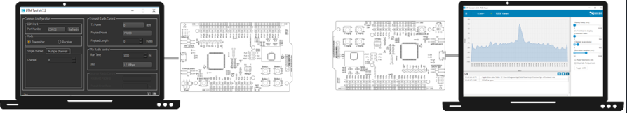

I used Direct test mode and in Transmitter tab using single channel mode. I have used used UART to set up connection with desktop and the chip.
In DTM mode we can able to transmit the power from the chip, that can be measured using at the other end with help of spectrum analyzer.

    For the RSSI I would again reefer to the my initial post as they use the same example and discuss how to get the RSSI value. As for how to store the data is a bit up to your preferences. For Windows I like the tera term terminal and it has a option to store the terminal session values as a text file. Many terminals has this option, it is also possible to just mark the data from the terminal you wish to store and copy paste it into another document.
    As for the wave generator. It needs to have modulated carrier with the correct modulation and a valid data package. The easiest solution is to use the "low cost" setup described in the white paper with a calibrated RF attenuator between a nRF52840 DK and your custom board.
    I would recommend using the Radio Test Example, on the custom board, change the UART pins in the overlay to the UART pins in your custom board.
