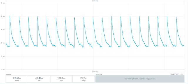

    However, the current I am measuring with my PPK2 is higher than what I would expect.  I was expecting to see ~ 2uA in idle mode, and then the current jump up to a few mA when it gets triggered out of idle mode.  But instead, I see this:
    Its jumping around between 20uA and 40uA at about 200Hz.
    Any idea why the current isn't sitting steady at around 2uA as expected?
    Mike
  • OK, I think I've sorted out my own issue.  Had the voltage of the PPK2 to the DUT set to 3.3V (that's what our custom hardware normally works off).  Setting it to 3.0V saw the current drop down to zero during idle, with a peak of about 2.5mA when I trigger it out of idle mode by sending a signal to the RX pin. Perhaps there is some sort of voltage clamping on the VDD rail if its above 3V?
    The only outstanding issue is that the idle current seems unrealistically low though.  It is literally 0uA!  Does that seem right? I wouldn't expect it to be that low, even in System OFF mode.
    Mike
  • It's because of the interrupt you are using for the wakeup. Try using port event to wakeup instead, for that my answer in this case could be helpful:
