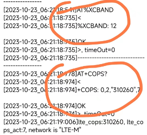

hi support team,
customer reported one problem that some of the sim card can't be attached to network, i have attached the logs, one log is success, another one fails.

[2023-10-23_06:21:18:250]AT%XCBAND=?
[2023-10-23_06:21:18:492]<
[2023-10-23_06:21:18:492]%XCBAND: (1,2,3,4,5,8,12,13,18,19,20,25,26,28,66)
[2023-10-23_06:21:18:492]OK
[2023-10-23_06:21:18:492]>, timeOut=0
[2023-10-23_06:21:18:492]--------------------------------------------
[2023-10-23_06:21:18:541]AT%XCBAND
[2023-10-23_06:21:18:735]<
[2023-10-23_06:21:18:735]%XCBAND: 12
[2023-10-23_06:21:18:735]OK
[2023-10-23_06:21:18:735]>, timeOut=0
[2023-10-23_06:21:18:735]--------------------------------------------
[2023-10-23_06:21:18:778]AT+COPS?
[2023-10-23_06:21:18:974]<
[2023-10-23_06:21:18:974]+COPS: 0,2,"310260",7
[2023-10-23_06:21:18:974]OK
[2023-10-23_06:21:18:974]>, timeOut=0
[2023-10-23_06:21:19:006]lte_cops:310260, lte_cops_act:7, network is "LTE-M"

and customer keeps 9160 on for a long time after setting at+cfun=1; but there is no way can make device attached to network.
and customer had another try to send command one by one:
1. AT+CFUN=4
2. AT+CGDCONT=0,"IP","soracom.io"
3. AT+CGAUTH=0,1,"sora","sora"
4. AT+CFUN=1
but the failure device still  got "+CGATT: 0" after sending "AT+CGATT?"
for now, we can't get the modem trace from endcustomer.i will attach it after i get it.
addition information is customer did factoryreset command to 9160 after startup.
then custome put the sim card to mobile phone, after several minutes, it attached to network operater, which is T-mobile,we can get mcc from log:
do we have any experience on this? usually how to deal with this situation?
customer is guessing mobile phone can activate the sim card,if we can do this.
William.
  • Hi William,
    "%XSYSTEMMODE: 1,0,0,0" shows the device is set to only connect with the LTE-M network, are you sure the local network operator used by the end customer has LTE-M coverage?
    I am not sure if the end customer is located in China, GSMA | Mobile IoT Deployment Map | Internet of Things shows only NB-IoT network is available in China mainland area.
    The mobile phone test with SIM card does not give more useful information, since one SIM card can have several profiles that may support 4G, 5G, LTE-M, NB-IoT networks and so on. Mobile phones normally do not support LTE-M networks.
    Charlie
  • Hi Charlie,
    the end customer is in the USA.
    they are using cat-m network, not nb:
    [2023-10-23_06:21:12:922]AT%XSYSTEMMODE?
    [2023-10-23_06:21:13:132]<
    [2023-10-23_06:21:13:132]%XSYSTEMMODE: 1,0,0,0
    [2023-10-23_06:21:13:132]OK
    the problem focus on: device can't attach the network, but after insert to mobile phone(for about 10-20 minutes), those sim cards are ok, and can work on 9160.
    for me, i have not seen this problem before.
    William.
  • Hi William,
    1) Do you know which city this customer doing the test in and do they use SIM cards from T-Mobile directly? I want to check if other customers reported a similar issue before.
    2) Did they try to use "AT+COPS" and "AT%XBANDLOC" to speed up the network searching process?
    Charlie
  • Hi Charlie,
    customer is in the USA Washington.
    No, this product is not able to select which kind of sim card customer will use.
    the question is, if this kind of problem is common, and if 9160 can solve this problem?
    i never heard of this problem before.
    William.
  • Hi William,
    Me neither, so we need to understand why this happens. Here I list some information that may help to understand the cause.
    1) Is it possible to use nRF9160DK to test and collect modem traces by the end customer?
    2)If only some SIM cards have an issue, I suspect the issue is SIM card configuration-related. Soracom shows their SIM cards support multiple networks, it may take time for nRF9160 to find the proper network, while mobile phones may have different strategies to search the proper network so it is faster. The following commands can speed up the search process, and this will help to verify if searching the network causes the long time wait. Just set the target network and band we have known to see if this will help the device connect to the network quickly.
    AT+COPS=1,2,"310260"
    AT%XBANDLOCK=2,"100000000000"
    Charlie
