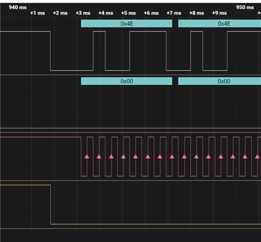

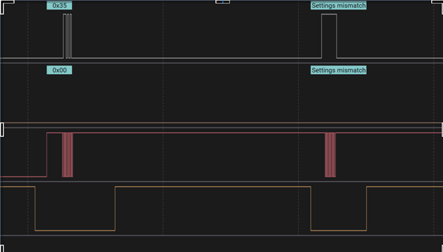

With that code i managed using a Saleae Logic analyser, on logic 2.4.1 to get those signal :
I will provide more photo if needed

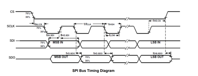

but if we compare with the datasheet
The difference are no answer from the slave + The cs goes low and after that the SPI sets in MODE 3, which I think might be a reason why it doesn't work, but only for the first time.
If you have any link and solution + example on how to implement SPI, I would be very grateful

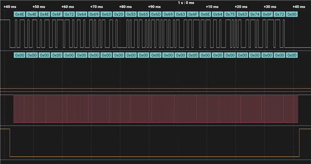

  • Hello Kenneth!, thank you for the links, I could not figure out how to make the zephyr one work, but the nrfx_spim example compiled after changing the line :
    #include "../../../common/common-pinctrl.dtsi"  to #include "../common/common-pinctrl.dtsi"
    I then added a CS pin, a frequency <1Mhz and SPI mode 3, and its seems to write the good data :
    ->full
    So On the Side of the nrf5340, the spi is working as expected and writing
    "NNNordic Semiconductor"
    The clock isn't acting weird anymore, so thank you.
    On the other side, I expected so random answer or anything from the sensor to see it alive, but I get nothing at all.
    If you have any idea why this could be I am
    interested, but the Spi seems to be working at least Slight smile So it's probably on the sensor side.
