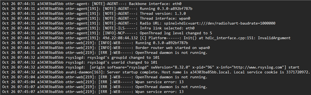

Build OpenThread on Ubuntu (physical machine) failed, but successed with the same hardware on the Raspberry PI
This problem has been bothering me for a long time, can you help me?
I built the Thread network with the following command steps and burned the matter light_bulb through 5340 to add the light_bulb as another node to the constructed Thread network.
Strangely enough, the Raspberry PI worked correctly and retrieved the activity set. But it did not run on my Ubuntu20.04 physical machine.

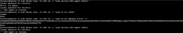

Raspberry Pi:
1.
2.

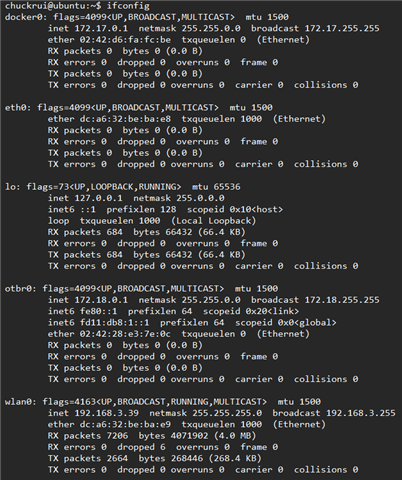

3.ifconfig
Ubuntu
1.
2.
From the running result of the command, it seems that otbr-agent does not start correctly in Ubuntu.

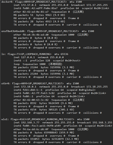

Then I found that the network adapter names of Ubuntu and Raspberry PI seem to be different.
Will this affect the construction of Thread network? Or is it something else?

    The problem is stated in the first screenshot for Ubuntu: "Init() at hdlc_interface.cpp:151: InvalidArgument". Do you have the RCP connected to the Ubuntu PC? Have you checked that it is connected on the correct path "/dev/ttyACM0"?

    I sure that i burned the flash on ncs path v2.3.0/nrf/samples/openthread/coprocessor,and then built it add 'Extra CMake arguments:-DOVERLAY_CONFIG="overlay-usb.conf" -DDTC_OVERLAY_FILE="usb. overlay" '.
    And when i connected 52840dongle to Ubuntu PC,the command of line "lsusb" it can saw the result:Nodic Semiconductor ASA USB2.1 Hub.
    Also the path is /dev/ttyACM0,because disconnected to my Ubuntu PC,it will disappear.

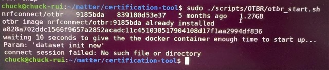

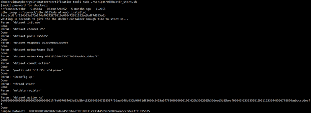

  • One important thing I want to say is that the same RCP (52840dongle), the same operation (build Thread network), failed to build on Ubuntu20.04Pc, but will succeed on Raspberry PI 4B, I don't know why.
  • Added: I have previously built the Thread network step by step on my own, and I have tried to build the Thread network with an automated.sh script file, which also failed on Ubuntu Pc, despite the same.sh file and the same RCP,.sh file link and error message as follows:
    Link:
    https://github.com/project-chip/certification-tool/tree/main/scripts/OTBR
    Ubuntu Pc:
    chuck@chuck-rui:~/matter/certification-tool$ otbr-agent -vvv

    Nov  6 07:14:47 chuck-rui mDNSResponder: Default: mDNSResponder (Engineering Build) (May 22 2023 09:44:34) starting
    Nov  6 07:14:47 chuck-rui mDNSResponder: Default: mDNS_AddDNSServer: Lock not held! mDNS_busy (0) mDNS_reentrancy (0)
    Nov  6 07:14:47 chuck-rui otbr-agent: [NOTE]-AGENT---: Backbone interface: eth0
    Nov  6 07:14:47 chuck-rui otbr-agent[153]: [NOTE]-AGENT---: Running 0.3.0-9185bdaaf4-dirty
    Nov  6 07:14:47 chuck-rui otbr-agent[153]: [NOTE]-AGENT---: Thread version: 1.3.0
    Nov  6 07:14:47 chuck-rui otbr-agent[153]: [NOTE]-AGENT---: Thread interface: wpan0
    Nov  6 07:14:47 chuck-rui otbr-agent[153]: [NOTE]-AGENT---: Radio URL: spinel+hdlc+uart:///dev/radio?uart-baudrate=115200
    Nov  6 07:14:47 chuck-rui otbr-agent[153]: [NOTE]-ILS-----: Infra link selected: eth0
    Nov  6 07:14:47 chuck-rui otbr-agent[153]: [INFO]-NCP-----: OpenThread log level changed to 5
    Nov  6 07:14:47 chuck-rui otbr-agent[153]: 49d.17:08:04.978 [I] Platform------: RCP reset: RESET_POWER_ON
    Nov  6 07:14:47 chuck-rui otbr-agent[153]: 49d.17:08:04.978 [I] Platform------: Software reset RCP successfully
    Nov  6 07:14:47 chuck-rui otbr-agent[153]: 49d.17:08:04.986 [C] Platform------: platformBackboneInit() at backbone.cpp:62: Failure
    Nov  6 07:14:48 chuck-rui rsyslogd: rsyslogd's groupid changed to 101
    Nov  6 07:14:48 chuck-rui rsyslogd: rsyslogd's userid changed to 101
    Nov  6 07:14:48 chuck-rui rsyslogd:  [origin software="rsyslogd" swVersion="8.32.0" x-pid="93" x-info="http://www.rsyslog.com"] start
    But Success on Raspberry Pi 4B:

  • Hi Jørgen,
    I'd like to confirm a point: when I build a Thread network, I will be 52840 as RCP, I burn firmware is replication/v2.3.0 / samples/openthread coprocessor firmware, I burn the firmware, do you have any questions?
