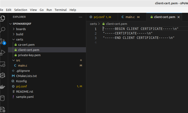

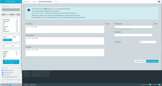

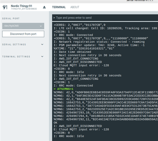

  • Hi Håkon,
    Could you please provide a procedure for provisioning the certificates that is correct? Because out of the several variants available in different part of the Nordic documentation, so far nothing changes the end result and I always end up with the ENOTCONN (-128) error which according to its comment is related to some socket and not with the credentials (I saw many cases where people get error 111, regarding the credentials).
    I worked exclusively with the Certificate Manager (in the Cellular Monitor application) and rewrote the certificates several times with:
    • different security tags (never the one reserved for the nRF Cloud)
    • with and without an empty new line after the closing line (-----END CERTIFICATE-----)
    • I even tried to add them into the dedicated files in the source tree (perfectly realising that this is most probably a deprecated practice)
    Beyond that I tried your proposal:
    Note that you should set your client id + hostname according to the AWS IoT settings, similar to this (XXYYZZ11 used as example here):
    although it doesn't make sense for the following reasons:
    • As AWS describe it in their own documentation - the first part of the broker host name is "an account specific prefix" and can't be matched to an individual devise (but even it it could then which one of the myriad registered devices?)
    • In our system we've registered so far some other types of devices too and the and it always worked this way: the Client ID is the unique ID given to the device by the AWS IoT Core registry and the broker host name is an MQTT endpoint for all the devices to connect to and is expected to always have the same constant value.
    Eventually, I'm still revolving around this state:
    and wonder how this socket connection requirement can be satisfied.
    Ivan

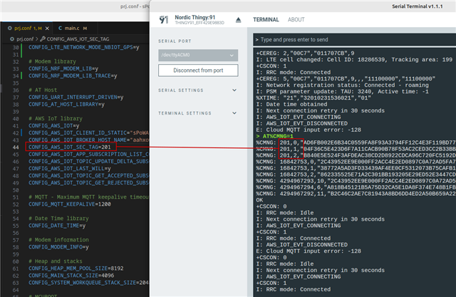

  • Hi Ivan,
    Are you targeting the correct SEC_TAG?
    In the aws_iot sample, this is by-default set to '201' - what is it set to in your firmware?
    This highly depends on how you've setup the project to load certificates.
    I used AT%CMNG, via the "certificate manager", where I manually copied in each certificate:
    Do not remove these, or alter the certificate in any way.
    Håkon
  • Hi Håkon,
    Since I've read in many places that the only limitation for the SEC_TAG's value is to be different than the one reserved for the nRF Cloud (the one already filled in when you open the Certificate Manager), I've used different values. But I've always been careful to keep the tag the same in both the certificates I provision, and the code sample I'm building (in the prj.conf).
    So now I just returned the value everywhere to 201, reprovisioned the three certificates the same way you describe it, and flashed the newly built app_signed.hex file. The result unfortunately was all the same:
    If I'm missing something I already have no idea what it might be ...
    Actually, I noticed something at some point. I'm not sure if it is relevant at all but at in all other cases we had (with other types of devices, including virtual ones - python scripts) it was always mandatory to specify the default secure MQTT port (8883). I've never found a related property in the code samples - is it something hardcoded deeper in the firmware?
