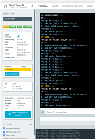

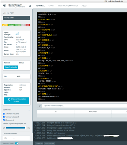

    I probably had to share that information earlier (I guess I forgot about this because it was covered in a previous ticket) - there is not LTE-M coverage in the country. There is maybe like one and a half (the second one is not official) provision of NB-IoT from the local operators. So we used that in order to register the Thingy in the nRFCloud initially (we used 1nce, because iBasis provided only LTE-M here).
    So, with that in the context, here are two more screenshots:
    and
    which I hope provide some relevant information. On the second one the UART indicator in the top-left corner constantly changes between yellow and red.
    And no - there no any other logs in the console over time. I really hoped to see something like this already.
    Ivan
  • Hi Ivan,
    Thanks for the added info. The screenshots still show no coverage.

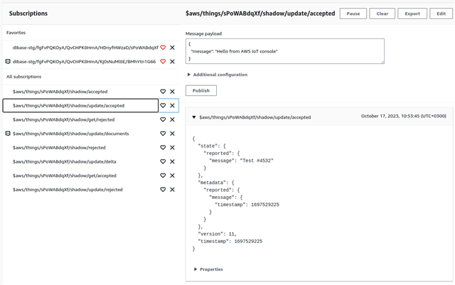

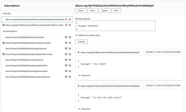

  • Hello Håkon,
    As you can see from the AWS' MQTT Client the communication goes successfully in both directions, which means the certificates and the security tag can not be the problem:
    Here is the log you requested:

    2023-10-17T07:46:52.258Z DEBUG modem << +CESQ: 99,99,255,255,25,63
    2023-10-17T07:46:52.265Z DEBUG modem << OK
    2023-10-17T07:47:02.291Z DEBUG modem << I: AWS_IOT_EVT_DISCONNECTED
    2023-10-17T07:47:02.312Z DEBUG modem << E: Cloud MQTT input error: -128
    2023-10-17T07:47:08.033Z DEBUG modem << +CSCON: 0
    2023-10-17T07:47:08.053Z DEBUG modem << I: RRC mode: Idle
    2023-10-17T07:47:08.395Z DEBUG modem << %CESQ: 60,3,22,3
    2023-10-17T07:47:18.611Z DEBUG modem << I: Next connection retry in 30 seconds
    2023-10-17T07:47:18.630Z DEBUG modem << I: AWS_IOT_EVT_CONNECTING
    2023-10-17T07:47:18.690Z DEBUG modem << %CESQ: 62,3,28,4
    2023-10-17T07:47:18.929Z DEBUG modem << +CSCON: 1
    2023-10-17T07:47:18.950Z DEBUG modem << I: RRC mode: Connected
    2023-10-17T07:47:22.237Z DEBUG modem >> AT+CESQ
    2023-10-17T07:47:22.282Z DEBUG modem << +CESQ: 99,99,255,255,29,62
    2023-10-17T07:47:22.288Z DEBUG modem << OK
    2023-10-17T07:47:33.011Z DEBUG modem << I: AWS_IOT_EVT_DISCONNECTED
    2023-10-17T07:47:33.019Z DEBUG modem << E: Cloud MQTT input error: -128
    2023-10-17T07:47:38.753Z DEBUG modem << +CSCON: 0
    2023-10-17T07:47:38.773Z DEBUG modem << I: RRC mode: Idle
    2023-10-17T07:47:40.107Z DEBUG modem << %CESQ: 62,3,22,3
    2023-10-17T07:47:48.612Z DEBUG modem << I: Next connection retry in 30 seconds
    2023-10-17T07:47:48.616Z DEBUG modem << I: AWS_IOT_EVT_CONNECTING
    2023-10-17T07:47:48.709Z DEBUG modem << %CESQ: 59,2,27,3
    2023-10-17T07:47:49.007Z DEBUG modem << +CSCON: 1
    2023-10-17T07:47:49.012Z DEBUG modem << I: RRC mode: Connected
    2023-10-17T07:47:52.237Z DEBUG modem >> AT+CESQ
    2023-10-17T07:47:52.280Z DEBUG modem << +CESQ: 99,99,255,255,25,61
    2023-10-17T07:47:52.289Z DEBUG modem << OK
    2023-10-17T07:48:02.131Z DEBUG modem << I: AWS_IOT_EVT_DISCONNECTED
    2023-10-17T07:48:02.148Z DEBUG modem << E: Cloud MQTT input error: -128
    2023-10-17T07:48:07.873Z DEBUG modem << +CSCON: 0
    2023-10-17T07:48:07.880Z DEBUG modem << I: RRC mode: Idle
    2023-10-17T07:48:08.235Z DEBUG modem << %CESQ: 61,3,22,3
    2023-10-17T07:48:18.614Z DEBUG modem << I: Next connection retry in 30 seconds
    2023-10-17T07:48:18.634Z DEBUG modem << I: AWS_IOT_EVT_CONNECTING
    2023-10-17T07:48:18.928Z DEBUG modem << +CSCON: 1
    2023-10-17T07:48:18.939Z DEBUG modem << I: RRC mode: Connected
    2023-10-17T07:48:22.237Z DEBUG modem >> AT+CESQ
    2023-10-17T07:48:22.283Z DEBUG modem << +CESQ: 99,99,255,255,24,60
    2023-10-17T07:48:22.290Z DEBUG modem << OK
    2023-10-17T07:48:27.522Z DEBUG modem << %CESQ: 62,3,27,3
    2023-10-17T07:48:33.624Z DEBUG modem << I: AWS_IOT_EVT_DISCONNECTED
    2023-10-17T07:48:33.645Z DEBUG modem << E: Cloud MQTT input error: -128
    2023-10-17T07:48:39.393Z DEBUG modem << +CSCON: 0
    2023-10-17T07:48:39.415Z DEBUG modem << I: RRC mode: Idle
    2023-10-17T07:48:46.678Z DEBUG modem << %CESQ: 61,3,21,3
    2023-10-17T07:48:48.616Z DEBUG modem << I: Next connection retry in 30 seconds
    2023-10-17T07:48:48.635Z DEBUG modem << I: AWS_IOT_EVT_CONNECTING
    2023-10-17T07:48:48.709Z DEBUG modem << %CESQ: 61,3,29,4
    2023-10-17T07:48:49.007Z DEBUG modem << +CSCON: 1
    2023-10-17T07:48:49.027Z DEBUG modem << I: RRC mode: Connected
    2023-10-17T07:48:52.236Z DEBUG modem >> AT+CESQ
    2023-10-17T07:48:52.262Z DEBUG modem << +CESQ: 99,99,255,255,27,63
    2023-10-17T07:48:52.271Z DEBUG modem << OK
    2023-10-17T07:48:52.842Z DEBUG modem << %CESQ: 62,3,24,3
    2023-10-17T07:49:03.236Z DEBUG modem << I: AWS_IOT_EVT_DISCONNECTED
    2023-10-17T07:49:03.243Z DEBUG modem << E: Cloud MQTT input error: -128
    2023-10-17T07:49:03.410Z DEBUG modem << %CESQ: 64,3,29,4
    2023-10-17T07:49:08.993Z DEBUG modem << +CSCON: 0
    2023-10-17T07:49:09.013Z DEBUG modem << I: RRC mode: Idle
    2023-10-17T07:49:09.355Z DEBUG modem << %CESQ: 62,3,23,3
    2023-10-17T07:49:17.397Z DEBUG modem << %CESQ: 57,2,22,3
    2023-10-17T07:49:18.618Z DEBUG modem << I: Next connection retry in 30 seconds
    2023-10-17T07:49:18.624Z DEBUG modem << I: AWS_IOT_EVT_CONNECTING
    2023-10-17T07:49:18.712Z DEBUG modem << %CESQ: 60,3,28,4
    2023-10-17T07:49:18.929Z DEBUG modem << +CSCON: 1
    2023-10-17T07:49:18.941Z DEBUG modem << I: RRC mode: Connected
    2023-10-17T07:49:22.237Z DEBUG modem >> AT+CESQ
    2023-10-17T07:49:22.281Z DEBUG modem << +CESQ: 99,99,255,255,25,59
    2023-10-17T07:49:22.287Z DEBUG modem << OK
    2023-10-17T07:49:23.068Z DEBUG modem << %CESQ: 59,2,23,3
    2023-10-17T07:49:31.851Z DEBUG modem << %CESQ: 54,2,22,3
    2023-10-17T07:49:31.908Z DEBUG modem << I: AWS_IOT_EVT_DISCONNECTED
    2023-10-17T07:49:31.913Z DEBUG modem << E: Cloud MQTT input error: -128
    2023-10-17T07:49:37.633Z DEBUG modem << +CSCON: 0
    2023-10-17T07:49:37.652Z DEBUG modem << I: RRC mode: Idle
    2023-10-17T07:49:48.621Z DEBUG modem << I: Next connection retry in 30 seconds
    2023-10-17T07:49:48.636Z DEBUG modem << I: AWS_IOT_EVT_CONNECTING
    2023-10-17T07:49:49.008Z DEBUG modem << +CSCON: 1
    2023-10-17T07:49:49.024Z DEBUG modem << I: RRC mode: Connected
    2023-10-17T07:49:52.239Z DEBUG modem >> AT+CESQ
    2023-10-17T07:49:52.285Z DEBUG modem << +CESQ: 99,99,255,255,22,56
    2023-10-17T07:49:52.291Z DEBUG modem << OK
    2023-10-17T07:49:53.402Z DEBUG modem << %CESQ: 59,2,24,3
    2023-10-17T07:50:03.908Z DEBUG modem << I: AWS_IOT_EVT_DISCONNECTED
    2023-10-17T07:50:03.914Z DEBUG modem << E: Cloud MQTT input error: -128
    2023-10-17T07:50:07.971Z DEBUG modem << %CESQ: 62,3,29,4
    2023-10-17T07:50:09.633Z DEBUG modem << +CSCON: 0
    2023-10-17T07:50:09.651Z DEBUG modem << I: RRC mode: Idle
    2023-10-17T07:50:09.837Z DEBUG modem << %CESQ: 61,3,21,3
    2023-10-17T07:50:18.623Z DEBUG modem << I: Next connection retry in 30 seconds
    2023-10-17T07:50:18.644Z DEBUG modem << I: AWS_IOT_EVT_CONNECTING
    2023-10-17T07:50:18.789Z DEBUG modem << %CESQ: 61,3,27,3
    2023-10-17T07:50:19.087Z DEBUG modem << +CSCON: 1
    2023-10-17T07:50:19.096Z DEBUG modem << I: RRC mode: Connected
    2023-10-17T07:50:22.237Z DEBUG modem >> AT+CESQ
    2023-10-17T07:50:22.284Z DEBUG modem << +CESQ: 99,99,255,255,26,62
    2023-10-17T07:50:22.290Z DEBUG modem << OK
    2023-10-17T07:50:33.332Z DEBUG modem << I: AWS_IOT_EVT_DISCONNECTED
    2023-10-17T07:50:33.351Z DEBUG modem << E: Cloud MQTT input error: -128
    2023-10-17T07:50:39.073Z DEBUG modem << +CSCON: 0
    2023-10-17T07:50:39.092Z DEBUG modem << I: RRC mode: Idle
    2023-10-17T07:50:39.275Z DEBUG modem << %CESQ: 61,3,22,3
    2023-10-17T07:50:48.625Z DEBUG modem << I: Next connection retry in 30 seconds
    2023-10-17T07:50:48.644Z DEBUG modem << I: AWS_IOT_EVT_CONNECTING
    2023-10-17T07:50:48.730Z DEBUG modem << %CESQ: 66,3,29,4
    2023-10-17T07:50:49.007Z DEBUG modem << +CSCON: 1
    2023-10-17T07:50:49.014Z DEBUG modem << I: RRC mode: Connected
    2023-10-17T07:50:52.239Z DEBUG modem >> AT+CESQ
    2023-10-17T07:50:52.285Z DEBUG modem << +CESQ: 99,99,255,255,27,65
    2023-10-17T07:50:52.292Z DEBUG modem << OK
    2023-10-17T07:50:52.850Z DEBUG modem << %CESQ: 64,3,24,3
    2023-10-17T07:50:58.587Z DEBUG modem << %CESQ: 65,3,29,4
    2023-10-17T07:51:02.451Z DEBUG modem << I: AWS_IOT_EVT_DISCONNECTED
    2023-10-17T07:51:02.471Z DEBUG modem << E: Cloud MQTT input error: -128
    2023-10-17T07:51:08.193Z DEBUG modem << +CSCON: 0
    2023-10-17T07:51:08.198Z DEBUG modem << I: RRC mode: Idle
    2023-10-17T07:51:08.395Z DEBUG modem << %CESQ: 64,3,22,3
    2023-10-17T07:51:18.627Z DEBUG modem << I: Next connection retry in 30 seconds
    2023-10-17T07:51:18.648Z DEBUG modem << I: AWS_IOT_EVT_CONNECTING
    2023-10-17T07:51:18.709Z DEBUG modem << %CESQ: 63,3,27,3
    2023-10-17T07:51:18.927Z DEBUG modem << +CSCON: 1
    2023-10-17T07:51:18.946Z DEBUG modem << I: RRC mode: Connected
    2023-10-17T07:51:22.237Z DEBUG modem >> AT+CESQ
    2023-10-17T07:51:22.285Z DEBUG modem << +CESQ: 99,99,255,255,25,64
    2023-10-17T07:51:22.292Z DEBUG modem << OK
    2023-10-17T07:51:32.388Z DEBUG modem << I: AWS_IOT_EVT_DISCONNECTED
    2023-10-17T07:51:32.393Z DEBUG modem << E: Cloud MQTT input error: -128
    2023-10-17T07:51:38.113Z DEBUG modem << +CSCON: 0
    2023-10-17T07:51:38.134Z DEBUG modem << I: RRC mode: Idle
    2023-10-17T07:51:40.747Z DEBUG modem << %CESQ: 65,3,20,2
    2023-10-17T07:51:48.630Z DEBUG modem << I: Next connection retry in 30 seconds
    2023-10-17T07:51:48.651Z DEBUG modem << I: AWS_IOT_EVT_CONNECTING
    2023-10-17T07:51:48.730Z DEBUG modem << %CESQ: 64,3,26,3
    2023-10-17T07:51:49.007Z DEBUG modem << +CSCON: 1
    2023-10-17T07:51:49.028Z DEBUG modem << I: RRC mode: Connected
    2023-10-17T07:51:52.237Z DEBUG modem >> AT+CESQ
    2023-10-17T07:51:52.249Z DEBUG modem << +CESQ: 99,99,255,255,26,64
    2023-10-17T07:51:52.256Z DEBUG modem << OK
    2023-10-17T07:52:04.036Z DEBUG modem << I: AWS_IOT_EVT_DISCONNECTED
    2023-10-17T07:52:04.042Z DEBUG modem << E: Cloud MQTT input error: -128
    2023-10-17T07:52:09.793Z DEBUG modem << +CSCON: 0
    2023-10-17T07:52:09.814Z DEBUG modem << I: RRC mode: Idle
    2023-10-17T07:52:10.154Z DEBUG modem << %CESQ: 61,3,21,3
    2023-10-17T07:52:18.631Z DEBUG modem << I: Next connection retry in 30 seconds
    2023-10-17T07:52:18.637Z DEBUG modem << I: AWS_IOT_EVT_CONNECTING
    2023-10-17T07:52:18.729Z DEBUG modem << %CESQ: 63,3,26,3
    2023-10-17T07:52:18.927Z DEBUG modem << +CSCON: 1
    2023-10-17T07:52:18.932Z DEBUG modem << I: RRC mode: Connected
    2023-10-17T07:52:22.237Z DEBUG modem >> AT+CESQ
    2023-10-17T07:52:22.295Z DEBUG modem << +CESQ: 99,99,255,255,25,61
    2023-10-17T07:52:22.305Z DEBUG modem << OK
    2023-10-17T07:52:32.388Z DEBUG modem << I: AWS_IOT_EVT_DISCONNECTED
    2023-10-17T07:52:32.413Z DEBUG modem << E: Cloud MQTT input error: -128
    2023-10-17T07:52:38.113Z DEBUG modem << +CSCON: 0
    2023-10-17T07:52:38.133Z DEBUG modem << I: RRC mode: Idle
    2023-10-17T07:52:48.635Z DEBUG modem << I: Next connection retry in 30 seconds
    2023-10-17T07:52:48.656Z DEBUG modem << I: AWS_IOT_EVT_CONNECTING
    2023-10-17T07:52:49.007Z DEBUG modem << +CSCON: 1
    2023-10-17T07:52:49.028Z DEBUG modem << I: RRC mode: Connected
    2023-10-17T07:52:52.238Z DEBUG modem >> AT+CESQ
    2023-10-17T07:52:52.287Z DEBUG modem << +CESQ: 99,99,255,255,26,62
    2023-10-17T07:52:52.294Z DEBUG modem << OK
    2023-10-17T07:53:03.093Z DEBUG modem << I: AWS_IOT_EVT_DISCONNECTED
    2023-10-17T07:53:03.100Z DEBUG modem << E: Cloud MQTT input error: -128
    2023-10-17T07:53:07.611Z DEBUG modem << %CESQ: 58,2,27,3
    2023-10-17T07:53:08.835Z DEBUG modem << +CSCON: 0
    2023-10-17T07:53:08.847Z DEBUG modem << I: RRC mode: Idle
    2023-10-17T07:53:09.035Z DEBUG modem << %CESQ: 61,3,22,3
    2023-10-17T07:53:18.636Z DEBUG modem << I: Next connection retry in 30 seconds
    2023-10-17T07:53:18.642Z DEBUG modem << I: AWS_IOT_EVT_CONNECTING
    2023-10-17T07:53:18.729Z DEBUG modem << %CESQ: 60,3,27,3
    2023-10-17T07:53:18.927Z DEBUG modem << +CSCON: 1
    2023-10-17T07:53:18.933Z DEBUG modem << I: RRC mode: Connected
    2023-10-17T07:53:22.236Z DEBUG modem >> AT+CESQ
    2023-10-17T07:53:22.266Z DEBUG modem << +CESQ: 99,99,255,255,25,61
    2023-10-17T07:53:22.273Z DEBUG modem << OK
    2023-10-17T07:53:33.959Z DEBUG modem << I: AWS_IOT_EVT_DISCONNECTED
    2023-10-17T07:53:33.979Z DEBUG modem << E: Cloud MQTT input error: -128
    2023-10-17T07:53:39.713Z DEBUG modem << +CSCON: 0
    2023-10-17T07:53:39.729Z DEBUG modem << I: RRC mode: Idle
    2023-10-17T07:53:43.627Z DEBUG modem << %CESQ: 61,3,19,2
    2023-10-17T07:53:48.638Z DEBUG modem << I: Next connection retry in 30 seconds
    2023-10-17T07:53:48.644Z DEBUG modem << I: AWS_IOT_EVT_CONNECTING
    2023-10-17T07:53:48.829Z DEBUG modem << %CESQ: 62,3,27,3
    2023-10-17T07:53:49.007Z DEBUG modem << +CSCON: 1
    2023-10-17T07:53:49.018Z DEBUG modem << I: RRC mode: Connected
    2023-10-17T07:53:52.236Z DEBUG modem >> AT+CESQ
    2023-10-17T07:53:52.247Z DEBUG modem << +CESQ: 99,99,255,255,24,62
    2023-10-17T07:53:52.255Z DEBUG modem << OK
    2023-10-17T07:54:02.469Z DEBUG modem << I: AWS_IOT_EVT_DISCONNECTED
    2023-10-17T07:54:02.492Z DEBUG modem << E: Cloud MQTT input error: -128
    2023-10-17T07:54:08.193Z DEBUG modem << +CSCON: 0
    2023-10-17T07:54:08.200Z DEBUG modem << I: RRC mode: Idle
    2023-10-17T07:54:14.347Z DEBUG modem << %CESQ: 63,3,21,3
    2023-10-17T07:54:18.641Z DEBUG modem << I: Next connection retry in 30 seconds
    2023-10-17T07:54:18.649Z DEBUG modem << I: AWS_IOT_EVT_CONNECTING
    2023-10-17T07:54:18.730Z DEBUG modem << %CESQ: 61,3,28,4
    2023-10-17T07:54:18.927Z DEBUG modem << +CSCON: 1
    2023-10-17T07:54:18.949Z DEBUG modem << I: RRC mode: Connected
    2023-10-17T07:54:22.237Z DEBUG modem >> AT+CESQ
    2023-10-17T07:54:22.268Z DEBUG modem << +CESQ: 99,99,255,255,24,61
    2023-10-17T07:54:22.275Z DEBUG modem << OK
    2023-10-17T07:54:22.362Z DEBUG modem << %CESQ: 61,3,23,3
    2023-10-17T07:54:28.295Z DEBUG modem << %CESQ: 56,2,23,3
    2023-10-17T07:54:31.891Z DEBUG modem << I: AWS_IOT_EVT_DISCONNECTED
    2023-10-17T07:54:31.897Z DEBUG modem << E: Cloud MQTT input error: -128
    2023-10-17T07:54:37.633Z DEBUG modem << +CSCON: 0
    2023-10-17T07:54:37.640Z DEBUG modem << I: RRC mode: Idle
    2023-10-17T07:54:37.995Z DEBUG modem << %CESQ: 62,3,23,3
    2023-10-17T07:54:48.643Z DEBUG modem << I: Next connection retry in 30 seconds
    2023-10-17T07:54:48.651Z DEBUG modem << I: AWS_IOT_EVT_CONNECTING
    2023-10-17T07:54:49.007Z DEBUG modem << +CSCON: 1
    2023-10-17T07:54:49.012Z DEBUG modem << I: RRC mode: Connected
    2023-10-17T07:54:51.588Z DEBUG modem << %CESQ: 62,3,28,4
    2023-10-17T07:54:52.236Z DEBUG modem >> AT+CESQ
    2023-10-17T07:54:52.288Z DEBUG modem << +CESQ: 99,99,255,255,27,62
    2023-10-17T07:54:52.295Z DEBUG modem << OK
    2023-10-17T07:54:53.442Z DEBUG modem << %CESQ: 60,3,23,3
    2023-10-17T07:55:02.235Z DEBUG modem << %CESQ: 61,3,28,4
    2023-10-17T07:55:03.588Z DEBUG modem << I: AWS_IOT_EVT_DISCONNECTED
    2023-10-17T07:55:03.595Z DEBUG modem << E: Cloud MQTT input error: -128
    2023-10-17T07:55:09.313Z DEBUG modem << +CSCON: 0
    2023-10-17T07:55:09.320Z DEBUG modem << I: RRC mode: Idle
    2023-10-17T07:55:10.678Z DEBUG modem << %CESQ: 60,3,20,2
    2023-10-17T07:55:18.645Z DEBUG modem << I: Next connection retry in 30 seconds
    2023-10-17T07:55:18.660Z DEBUG modem << I: AWS_IOT_EVT_CONNECTING
    2023-10-17T07:55:18.729Z DEBUG modem << %CESQ: 60,3,27,3
    2023-10-17T07:55:18.928Z DEBUG modem << +CSCON: 1
    2023-10-17T07:55:18.955Z DEBUG modem << I: RRC mode: Connected
    2023-10-17T07:55:22.236Z DEBUG modem >> AT+CESQ
    2023-10-17T07:55:22.269Z DEBUG modem << +CESQ: 99,99,255,255,26,61
    2023-10-17T07:55:22.276Z DEBUG modem << OK
    2023-10-17T07:55:33.474Z DEBUG modem << I: AWS_IOT_EVT_DISCONNECTED
    2023-10-17T07:55:33.480Z DEBUG modem << E: Cloud MQTT input error: -128
    2023-10-17T07:55:39.233Z DEBUG modem << +CSCON: 0
    2023-10-17T07:55:39.245Z DEBUG modem << I: RRC mode: Idle
    2023-10-17T07:55:39.435Z DEBUG modem << %CESQ: 60,3,21,3
    2023-10-17T07:55:48.647Z DEBUG modem << I: Next connection retry in 30 seconds
    2023-10-17T07:55:48.656Z DEBUG modem << I: AWS_IOT_EVT_CONNECTING
    2023-10-17T07:55:48.749Z DEBUG modem << %CESQ: 60,3,28,4
    2023-10-17T07:55:49.007Z DEBUG modem << +CSCON: 1
    2023-10-17T07:55:49.013Z DEBUG modem << I: RRC mode: Connected
    2023-10-17T07:55:52.237Z DEBUG modem >> AT+CESQ
    2023-10-17T07:55:52.297Z DEBUG modem << +CESQ: 99,99,255,255,24,62
    2023-10-17T07:55:52.303Z DEBUG modem << OK
    2023-10-17T07:56:02.133Z DEBUG modem << I: AWS_IOT_EVT_DISCONNECTED
    2023-10-17T07:56:02.142Z DEBUG modem << E: Cloud MQTT input error: -128
    2023-10-17T07:56:07.874Z DEBUG modem << +CSCON: 0
    2023-10-17T07:56:07.889Z DEBUG modem << I: RRC mode: Idle
    2023-10-17T07:56:08.235Z DEBUG modem << %CESQ: 63,3,22,3
    2023-10-17T07:56:18.649Z DEBUG modem << I: Next connection retry in 30 seconds
    2023-10-17T07:56:18.667Z DEBUG modem << I: AWS_IOT_EVT_CONNECTING
    2023-10-17T07:56:18.749Z DEBUG modem << %CESQ: 60,3,27,3
    2023-10-17T07:56:18.928Z DEBUG modem << +CSCON: 1
    2023-10-17T07:56:18.949Z DEBUG modem << I: RRC mode: Connected
    2023-10-17T07:56:22.236Z DEBUG modem >> AT+CESQ
    2023-10-17T07:56:22.284Z DEBUG modem << +CESQ: 99,99,255,255,26,61
    2023-10-17T07:56:22.289Z DEBUG modem << OK
    2023-10-17T07:56:37.491Z DEBUG modem << I: AWS_IOT_EVT_DISCONNECTED
    2023-10-17T07:56:37.500Z DEBUG modem << E: Cloud MQTT input error: -128
    2023-10-17T07:56:43.233Z DEBUG modem << +CSCON: 0
    2023-10-17T07:56:43.249Z DEBUG modem << I: RRC mode: Idle
    2023-10-17T07:56:47.948Z DEBUG modem << %CESQ: 62,3,19,2
    2023-10-17T07:56:48.652Z DEBUG modem << I: Next connection retry in 30 seconds
    2023-10-17T07:56:48.659Z DEBUG modem << I: AWS_IOT_EVT_CONNECTING
    2023-10-17T07:56:48.749Z DEBUG modem << %CESQ: 62,3,29,4
    2023-10-17T07:56:49.008Z DEBUG modem << +CSCON: 1
    2023-10-17T07:56:49.030Z DEBUG modem << I: RRC mode: Connected
    2023-10-17T07:56:52.237Z DEBUG modem >> AT+CESQ
    2023-10-17T07:56:52.289Z DEBUG modem << +CESQ: 99,99,255,255,26,63
    2023-10-17T07:56:52.295Z DEBUG modem << OK
    2023-10-17T07:56:55.908Z DEBUG modem << %CESQ: 62,3,24,3
    2023-10-17T07:57:02.435Z DEBUG modem << I: AWS_IOT_EVT_DISCONNECTED
    2023-10-17T07:57:02.455Z DEBUG modem << E: Cloud MQTT input error: -128
    2023-10-17T07:57:08.194Z DEBUG modem << +CSCON: 0
    2023-10-17T07:57:08.215Z DEBUG modem << I: RRC mode: Idle
    2023-10-17T07:57:18.654Z DEBUG modem << I: Next connection retry in 30 seconds
    2023-10-17T07:57:18.675Z DEBUG modem << I: AWS_IOT_EVT_CONNECTING
    2023-10-17T07:57:18.719Z DEBUG modem << %CESQ: 61,3,19,2
    2023-10-17T07:57:18.753Z DEBUG modem << %CESQ: 62,3,26,3
    2023-10-17T07:57:18.928Z DEBUG modem << +CSCON: 1
    2023-10-17T07:57:18.950Z DEBUG modem << I: RRC mode: Connected
    2023-10-17T07:57:22.237Z DEBUG modem >> AT+CESQ
    2023-10-17T07:57:22.291Z DEBUG modem << +CESQ: 99,99,255,255,23,59
    2023-10-17T07:57:22.297Z DEBUG modem << OK
    2023-10-17T07:57:32.854Z DEBUG modem << I: AWS_IOT_EVT_DISCONNECTED
    2023-10-17T07:57:32.878Z DEBUG modem << E: Cloud MQTT input error: -128
    2023-10-17T07:57:38.593Z DEBUG modem << +CSCON: 0
    2023-10-17T07:57:38.615Z DEBUG modem << I: RRC mode: Idle
    2023-10-17T07:57:44.280Z DEBUG modem << %CESQ: 59,2,21,3
    2023-10-17T07:57:48.657Z DEBUG modem << I: Next connection retry in 30 seconds
    2023-10-17T07:57:48.676Z DEBUG modem << I: AWS_IOT_EVT_CONNECTING
    2023-10-17T07:57:48.750Z DEBUG modem << %CESQ: 60,3,26,3
    2023-10-17T07:57:49.008Z DEBUG modem << +CSCON: 1
    2023-10-17T07:57:49.025Z DEBUG modem << I: RRC mode: Connected
    2023-10-17T07:57:52.236Z DEBUG modem >> AT+CESQ
    2023-10-17T07:57:52.272Z DEBUG modem << +CESQ: 99,99,255,255,26,60
    2023-10-17T07:57:52.278Z DEBUG modem << OK
    2023-10-17T07:58:04.037Z DEBUG modem << I: AWS_IOT_EVT_DISCONNECTED
    2023-10-17T07:58:04.059Z DEBUG modem << E: Cloud MQTT input error: -128
    2023-10-17T07:58:09.794Z DEBUG modem << +CSCON: 0
    2023-10-17T07:58:09.814Z DEBUG modem << I: RRC mode: Idle
    2023-10-17T07:58:14.988Z DEBUG modem << %CESQ: 62,3,18,2
    2023-10-17T07:58:18.658Z DEBUG modem << I: Next connection retry in 30 seconds
    2023-10-17T07:58:18.666Z DEBUG modem << I: AWS_IOT_EVT_CONNECTING
    2023-10-17T07:58:18.749Z DEBUG modem << %CESQ: 59,2,24,3
    2023-10-17T07:58:18.928Z DEBUG modem << +CSCON: 1
    2023-10-17T07:58:18.950Z DEBUG modem << I: RRC mode: Connected
    2023-10-17T07:58:22.237Z DEBUG modem >> AT+CESQ
    2023-10-17T07:58:22.296Z DEBUG modem << +CESQ: 99,99,255,255,24,61
    2023-10-17T07:58:22.302Z DEBUG modem << OK
    2023-10-17T07:58:32.853Z DEBUG modem << I: AWS_IOT_EVT_DISCONNECTED
    2023-10-17T07:58:32.878Z DEBUG modem << E: Cloud MQTT input error: -128
    2023-10-17T07:58:35.730Z DEBUG modem << %CESQ: 64,3,28,4
    2023-10-17T07:58:38.593Z DEBUG modem << +CSCON: 0
    2023-10-17T07:58:38.613Z DEBUG modem << I: RRC mode: Idle
    2023-10-17T07:58:38.955Z DEBUG modem << %CESQ: 61,3,21,3
    2023-10-17T07:58:45.739Z DEBUG modem << %CESQ: 61,3,26,3
    2023-10-17T07:58:48.660Z DEBUG modem << I: Next connection retry in 30 seconds
    2023-10-17T07:58:48.721Z DEBUG modem << I: AWS_IOT_EVT_CONNECTING
    2023-10-17T07:58:49.008Z DEBUG modem << +CSCON: 1
    2023-10-17T07:58:49.028Z DEBUG modem << I: RRC mode: Connected
    2023-10-17T07:58:52.236Z DEBUG modem >> AT+CESQ
    2023-10-17T07:58:52.248Z DEBUG modem << +CESQ: 99,99,255,255,24,61
    2023-10-17T07:58:52.258Z DEBUG modem << OK
    2023-10-17T07:59:02.469Z DEBUG modem << I: AWS_IOT_EVT_DISCONNECTED
    2023-10-17T07:59:02.492Z DEBUG modem << E: Cloud MQTT input error: -128
    2023-10-17T07:59:08.193Z DEBUG modem << +CSCON: 0
    2023-10-17T07:59:08.213Z DEBUG modem << I: RRC mode: Idle
    2023-10-17T07:59:11.307Z DEBUG modem << %CESQ: 63,3,19,2
    2023-10-17T07:59:16.459Z DEBUG modem << %CESQ: 62,3,24,3
    2023-10-17T07:59:18.663Z DEBUG modem << I: Next connection retry in 30 seconds
    2023-10-17T07:59:18.685Z DEBUG modem << I: AWS_IOT_EVT_CONNECTING
    2023-10-17T07:59:18.928Z DEBUG modem << +CSCON: 1
    2023-10-17T07:59:18.949Z DEBUG modem << I: RRC mode: Connected
    2023-10-17T07:59:22.237Z DEBUG modem >> AT+CESQ
    2023-10-17T07:59:22.294Z DEBUG modem << +CESQ: 99,99,255,255,26,61
    2023-10-17T07:59:22.301Z DEBUG modem << OK
    2023-10-17T07:59:33.012Z DEBUG modem << I: AWS_IOT_EVT_DISCONNECTED
    2023-10-17T07:59:33.020Z DEBUG modem << E: Cloud MQTT input error: -128
    2023-10-17T07:59:38.491Z DEBUG modem << %CESQ: 62,3,29,4
    2023-10-17T07:59:38.754Z DEBUG modem << +CSCON: 0
    2023-10-17T07:59:38.775Z DEBUG modem << I: RRC mode: Idle
    2023-10-17T07:59:39.115Z DEBUG modem << %CESQ: 64,3,23,3
    2023-10-17T07:59:48.666Z DEBUG modem << I: Next connection retry in 30 seconds
    2023-10-17T07:59:48.688Z DEBUG modem << I: AWS_IOT_EVT_CONNECTING
    2023-10-17T07:59:48.749Z DEBUG modem << %CESQ: 64,3,29,4
    2023-10-17T07:59:49.008Z DEBUG modem << +CSCON: 1
    2023-10-17T07:59:49.029Z DEBUG modem << I: RRC mode: Connected
    2023-10-17T07:59:51.642Z DEBUG modem << %CESQ: 62,3,24,3
    2023-10-17T07:59:52.237Z DEBUG modem >> AT+CESQ
    2023-10-17T07:59:52.293Z DEBUG modem << +CESQ: 99,99,255,255,25,62
    2023-10-17T07:59:52.299Z DEBUG modem << OK
    2023-10-17T08:00:02.277Z DEBUG modem << I: AWS_IOT_EVT_DISCONNECTED
    2023-10-17T08:00:02.289Z DEBUG modem << E: Cloud MQTT input error: -128
    2023-10-17T08:00:03.763Z DEBUG modem << %CESQ: 64,3,29,4
    2023-10-17T08:00:08.033Z DEBUG modem << +CSCON: 0
    2023-10-17T08:00:08.054Z DEBUG modem << I: RRC mode: Idle
    2023-10-17T08:00:08.235Z DEBUG modem << %CESQ: 63,3,24,3
    2023-10-17T08:00:12.747Z DEBUG modem << %CESQ: 62,3,19,2
    2023-10-17T08:00:18.667Z DEBUG modem << I: Next connection retry in 30 seconds
    2023-10-17T08:00:18.672Z DEBUG modem << I: AWS_IOT_EVT_CONNECTING
    2023-10-17T08:00:18.769Z DEBUG modem << %CESQ: 61,3,27,3
    2023-10-17T08:00:19.087Z DEBUG modem << +CSCON: 1
    2023-10-17T08:00:19.096Z DEBUG modem << I: RRC mode: Connected
    2023-10-17T08:00:22.236Z DEBUG modem >> AT+CESQ
    2023-10-17T08:00:22.266Z DEBUG modem << +CESQ: 99,99,255,255,25,62
    2023-10-17T08:00:22.274Z DEBUG modem << OK
    And it goes like this. The error seems to persist but it obviously doesn't hinder the communication.
    It looks like some sort of handshake fails.
