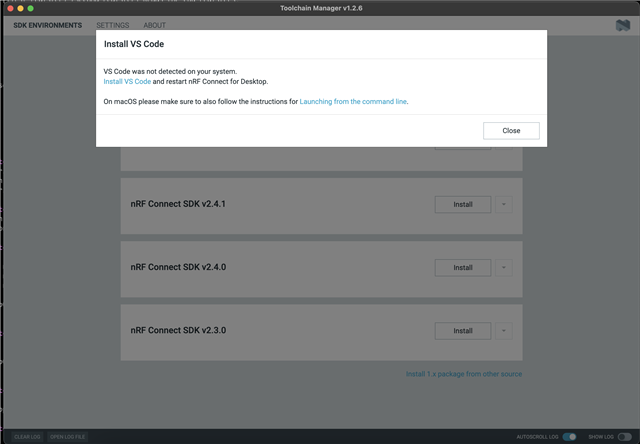

VS Code Was Not Detected M1 Mac
Current Configuration:

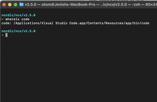

PATH was updated in the ~/.zprofile as:
export PATH="$PATH:/Applications/Visual Studio Code.app/Contents/Resources/app/bin"

I can not open VS Code from nRF Connect For Desktop -> Tool Chain Manager -> Open VS Code
Any idea what might be wrong here?

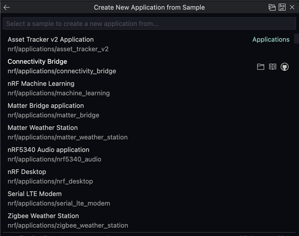

  • Thanks for sharing! Comparing to my setup, on my Macbook Air M2, I'm not seeing anything out of the ordinary. Could you test with e.g. Verbose mode in Toolchain Manager? This could maybe provide some feedback to what is failing.
    Are you able to build projects as expected in VS Code? This includes its own version of the Toolchain Manager, where you can add/remove different versions of the SDK and toolchain.
  • I can build the project without any issues.
    However, I do not have the Graphical User Interface that I have on Windows Machine.
  • Never Mind,
    I didn't realize that the board selector was in the top right corner of the pop window. Now, I can select board-specific examples.
    However, I can still not open VS Code from the nRF Connect For Desktop Application. I am not sure if that matters but FYI.
    Did you try with the verbose mode I asked?
  • Yes.
    It complained about JLink version not being v7.80c. I installed it through Universal Installer (X64, ARM64 didn't work). That warning disappeared. Other than that, the log files look clear. However, still can not open vscode using nRF Connect Tool Chain Manager UI. Log as per below:
    2023-11-02T18:47:02.604Z DEBUG Application data folder: /Users/atom/Library/Application Support/nrfconnect/pc-nrfconnect-toolchain-manager
    2023-11-02T18:47:03.961Z INFO Using nrf-device-lib-js version: 0.6.12
    2023-11-02T18:47:03.967Z INFO Using nrf-device-lib version: 0.15.3
    2023-11-02T18:47:03.968Z INFO Using nrfjprog DLL version: 10.19.1
    2023-11-02T18:47:03.969Z INFO Using JLink version: JLink_V7.80c

  • Thanks for testing and providing the logs. What if you add the path to ~/.zshrc ?
    It might be an issue with MacOS v14, I have been testing on v13.3. Will investigate with our developers.
  • I have already added the Code path to .zshrc.
    This is the cat:

  • What happens if you open a terminal in Toolchain Manager from the dropdown menu on the right hand side
    And then type in code
    Øyvind
  • I found the issue.
    It was the symbolic link that was broken in /usr/local/bin/code -> /Applications/Visual Studio Code.app/Contents/Resources/app/bin/code
    I had to remove this symlink, and recreate it under /user/local/bin with:
    sudo ln -S /Applications/Visual Studio Code.app/Contents/Resources/app/bin/code /usr/local/bin/code
    That fixed the issue of not being able to open VS Code from nRF Connect for Desktop Toolchain Manager.
    Thanks for your help!
