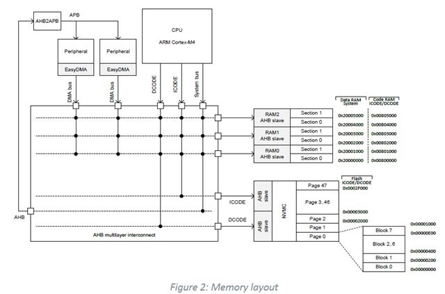

    I've managed to determine the loop is good, but when softdevice is enabled the reads tail off and stop.
    <info> app: Step2 11
    <info> app: Step2 10
    <info> app: Step2 15
    <info> app: Step2 16
    <info> app: Step2 17
    <info> app: Step2 -4
    <ends>
    I've now replaced the timer and PPI's with raw
      NRF_SAADC->EVENTS_STARTED = 0;
      NRF_SAADC->TASKS_START = SAADC_TASKS_START_TASKS_START_Trigger << SAADC_TASKS_START_TASKS_START_Pos;
      while (!NRF_SAADC->EVENTS_STARTED) {}
      NRF_SAADC->TASKS_SAMPLE = 1;
    Eventually I've found that the ADC dies if it's interrupt priority 4 or above. 3 works, above the softdevice non-critical timing ops. I can't tell why this is because I also have a few interrupts at higher levels and they are being serviced.
  • Right, so I've determined that it will mostly work with an RTC prescale of 9, but mostly the ADC will eventually fail and start giving crap out. At a prescale of 8 it will mostly not work and at 7 it's crap out all the time.
    A prescale of 9 equals 3631Hz, which is 274us.
    Something is interfering with the operation and it worsens as load increases (i.e run softdevice).

  • Really useful discussion :-)  Adding to this note a couple of additional ways to improve the SAADC. Instead of calibration another way is to read the temperature and apply a correction based on that, simple to characterise to get a good curve fit and the sort of thing done frequently on (say) the 32kHz crystal for better timekeeping.
    Avoiding data shift can be improved by reducing the underlying cause (this affects SPIM as well). This example is for the nRF52810.
    "EasyDMA is an AHB bus master similar to CPU and is connected to the AHB multilayer interconnect for direct access to Data RAM. AHB multilayer enables parallel access paths between multiple masters and slaves in a system. Access is resolved using priorities.
    Each bus master is connected to the slave devices using an interconnection matrix. The bus masters are assigned priorities. Priorities are used to resolve access when two (or more) bus masters request access to the same slave device. The following applies:
    • If two (or more) bus masters request access to the same slave device, the master with the highest priority is granted the access first.
    • Bus masters with lower priority are stalled until the higher priority master has completed its transaction.
    • If the higher priority master pauses at any point during its transaction, the lower priority master in queue is temporarily granted access to the slave device until the higher priority master resumes its activity.
    • Bus masters that have the same priority are mutually exclusive, thus cannot be used concurrently."
    nRF52810 Priorities
    Bus master name Description
    CPU
    SPIM0/SPIS0 Same priority and mutually exclusive
    RADIO
    CCM/ECB/AAR Same priority and mutually exclusive
    SAADC
    UARTE0
    TWIM0/TWIS0 Same priority and mutually exclusive
    PDM
    PWM
    CPU, RADIO and SPIM0 are likely to cause a stall on the SAADC DMA which can lead to a data shift; with a fixed streaming rate over DMA this is a problem. Reduce this likelihood by dedicating an AHB Bus Master-Slave to a single RAM segment reserved for the SAADC and low-usage cpu data.
