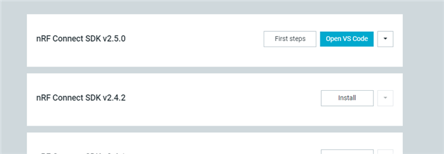

  • Hi Einar,
    Thanks for your reply. I updated both version to ncs version 2.5.0 in the process, so as far as i know the versions are the same, however there is a difference between the two setups. On Windows, when I am in the ncs extension in VS code I have the following info:
    On Linux, I am using toolchain v2.5.0, and after "Open west Manifest" it says 2.4.99. I don't know if that can cause the issue, and I didn't know how to update the manifest, so I could not verify that, but that might be it ?
