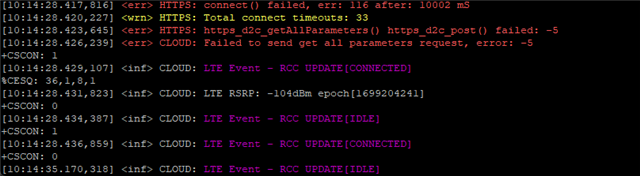

The issue we are seeing relates to the use of the connect() POSIX function. We use the same function for all of our various API calls to MongoDB. Here is a snippet:

Problem Overview
Most of the time this works fine and we typically see a connection time <= 3seconds. However depending on the network, time of day, and who know what else we will get a string of timeout errors (116) when calling connect(). Once they start happening they seem to continue. Even after power cycling and/or reset the timeouts seem to continue, which make me think that this is at least partly LTE network related.
I have attempt to increase the NET_SOCKETS_CONNECT_TIMEOUT to 30Sec (although it doesn't seem to allow more than 10Sec). this help's a little, but we will still frequency see strings of timeouts over the 10sec mark. I'm not sure if this is relevant but we also typically see a string of RCC events from the lte_event_handler cycling between CONNECT and IDLE around the same time we see the connect() timeout.
If the application is allowed to just run, we eventually see this go away and then have multiple hours of operations without a single timeout.  Additionally, we have another test location in a different state where we have also seem the same behavior.

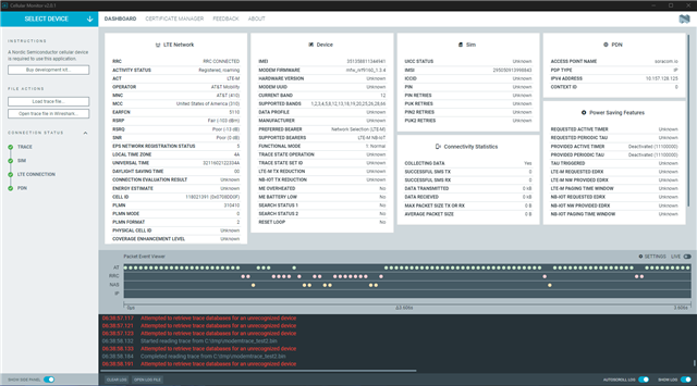

We have tried to collect a cellular trace without success, We only have uart0 and the RTT interface both of which we also use for logging. But we may take another shot at this.
