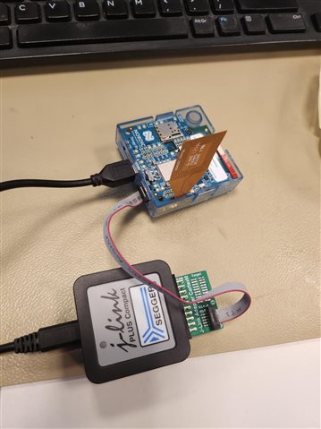

  1. Thingy 91
  2. Segger J-Link programmer to program nRF9160 and nRF52840 on the Thingy 91
  3. NCS v2.5.0
When I want to flash the nRF9160, I just put the SW2 in the nRF91 position and flash it with segger J-Link via vscode.
When I want to flash the nRF52840, I just put the SW2 in the nRF52840 position and flash it with segger J-Link via vscode.

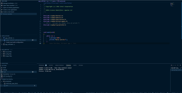

I am aware  that the Thingy 91 comes with a preflashed Asset tracker v2 application. In my case, I am not interested in none of that. I have reflashed the nRF52840 with connectivity bridge application and reflashed the nRF9160 with simple "hello world" application. I have just modified it slightly to print hello world in an infinite loop. The first thing I want to test is if I am able to see the printk messages on the console as that is always the first thing I setup when working on a project.
void main(void)
	while (1) {
        k_msleep(1000);
		printk("Hello world\n");

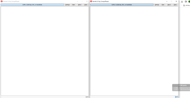

After I power the device, I can see 2 Serial ports appear. That is expected for the Connectivity Bridge application. I have opened both serial ports via serial terminal but I am not able to see any logs. I was under the impression that Conncetivity bridge application running on nRF52840 should forward all the printk messages of the nRF9160 device to one of the serial ports that appeared. Is that not the case?

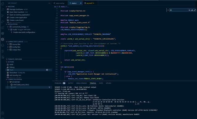

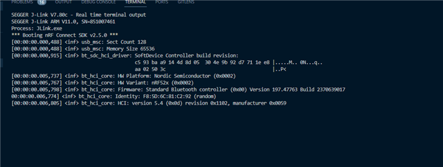

  • The messages in the RTT logger seems to indicate, that the "SWD selecting switch" selects the nRF52. (That's the small black switch between the usb and 10 pin swd, see Thingy:91 - Programming and debugging interface.)

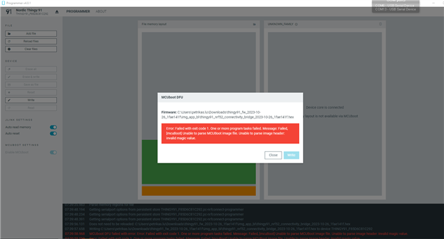

    With that, your JLINK flashs the nRF52840 of the thingy. Please flash the Connectivity bridge you find in the thingy91_fw_2023-10-26_1fae141f.zip (thingy91_fw_2023-10-26_1fae141f/img_app_bl/thingy91_nrf52_connectivity_bridge_2023-10-26_1fae141f.hex). The nRF Connect for Desktop / Programmer App may be used for that.
    Afterwards, switch the "SWD selecting switch" to select the nRF91. Then apply your sample and check, what happens.
  • As I have mentioned in my initial post, I have the connectivity bridge application running on the nRF52840 board. I have took it from the latest NCS v.2.5.0 and flashed it to nRF52840 via external programmer (Segger J-Link) using 10 pin SWD.
    See my setup below:

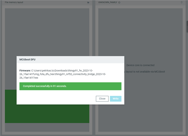

    I have tried to flash it via Programmer but for some reason I am not able to put it in MCUboot mode:
    I am holding the SW3 button pressed while switching ON the Thingy91. After it is turned ON, I release the SW3 but that does not seem to do anything. However, I am able to program the device with the following HEX:
    \thingy91_fw_2023-10-26_1fae141f\img_fota_dfu_hex
    Anyways, I prefer flashing the device using external Segger programmer via 10 pin SWD directly from the VSCode nRF Connect.

    When selecting the SWD switch to the nRF52 position and monitoring RTT logs:
    When selecting the SWD switch to the nRF91 position and monitoring RTT logs:

    The RTT log, which you mention to show the nRF9160 log , shows the nRF52840 log. Even if you aware of the "SWD select mode", you need to put that in the right position, or?
    SW3 => nRF9160
    SW4 => nRF52840
    Anyway, if the JLINK works that's a good first step. (it would also do with the Programmer app, just select the JLINK not the Thingy.)

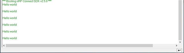

    Thank you for your help. While I was replying back to your comment I have realized the stupid mistake I have done. In my nrf9160DK code , I do the following:

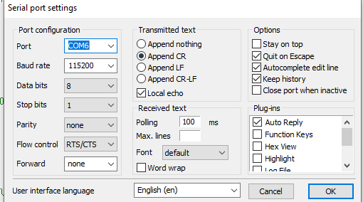

    However, in the serial terminal I used the following settings:
    Nottice "Append CR" setting. This setting makes the serial terminal to only print data when it is \r terminated....
    After replacing my initial hello world print with the following:
    printk("Hello world\n\r");
    I can confirm that it works as expected:
    Thank you  :)
