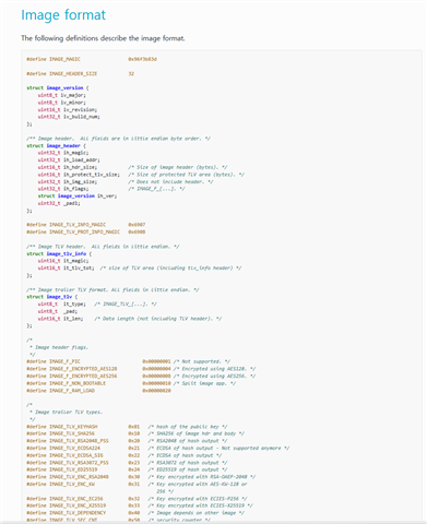

    And what is the purpose of below codes?
    As I know, these formats are c code.
    Where can I use this code?
    Everything is so confused.

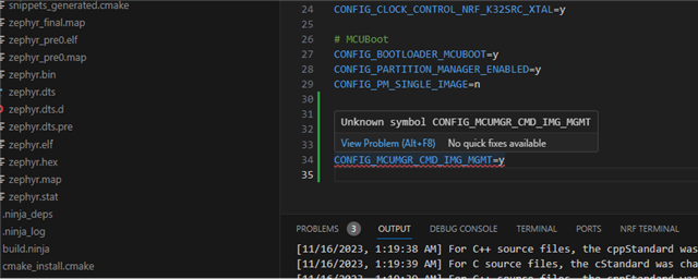

    I tried to follow DFU Guides, but I cannot set the configuation in prj.conf file.
    In the guide,
    # Enable most core commands.
    CONFIG_MCUMGR_CMD_IMG_MGMT=y
    CONFIG_MCUMGR_CMD_OS_MGMT=y
    But, I cannot apply these config.
    How can I do?
    Could you please try this:
    1. Clone peripheral_lbs sample.
    2. Add
    CONFIG_NCS_SAMPLE_MCUMGR_BT_OTA_DFU=y
    CONFIG_BOOTLOADER_MCUBOOT=y
    into prj.conf.
    After that your application will have smp service supported (FOTA) and you can start doing FOTA update via nRF Device Manager or  nRF Connect app.
