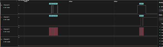

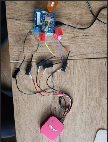

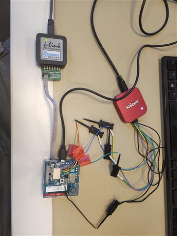

See image of my setup (I know it looks a bit chaotic):
As you can see from image above, I have soldered wires on the CS, MOSI, MISO and CLK and GND testpoints so I can connect logic analyzer.
Currently I am practising using spi_write.
See my code below:

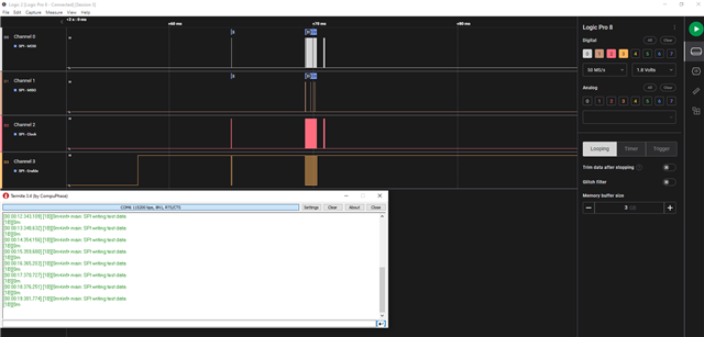

As you can see from the code above, I am expecting to send a simple SPI message periodically (every 1 second). But when I monitor signal using logic analyzer, it looks really weird:
It sends some garbage once and then never again so it does not work as expected. I believe it has to do something with the chip select as it stays HIGH.

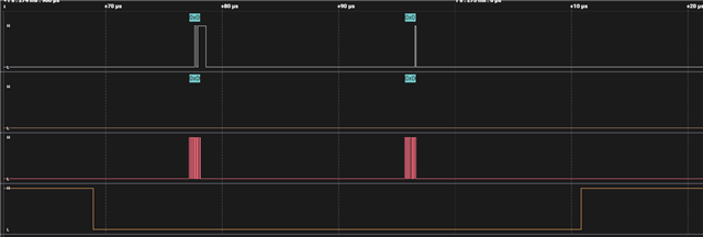

I am attaching Salae capture file below:
8311.adxl362_log3.sal
I would very much appreciate if someone could point me in the right direction. Perhaps you can spot an issue in my code? Why simple spi_write would not work ?

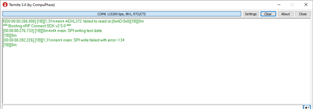

UPDATE
I have added some additional logs :
		err = spi_write(adxl1362_sens, &spi_cfg, &tx_bufs);
		if (err) {
			LOG_ERR("SPI write failed with error %d\n", err);
			return err;
The logs:
What is also very interesting, is that the device is spitting the log <err> ADXL372: failed to read id (0xAD:0x0)[1B][0m
which is very strange. In my code, I do nothing related to ADXL372. I only use ADXL362. Why would it print this error related to ADXL372?
Also, I have looked at zephyr errno documentation:
https://docs.zephyrproject.org/apidoc/latest/errno_8h.html
I have discovered that error -134 corresponds to ENOTSUP
but sadly that does not provide any useful information for me.
So to summarise everything up:
1. What is the correct way to configure  spi_cs_control? Is method that I used correct?
2. Why I am getting SPI write failed with error -134? Could that be related to the Chip select?
3. Why I am getting the following printed on the console:
[00:00:00.266,723] [1B][1;31m<err> ADXL372: failed to read id (0xAD:0x0)[1B][0m.

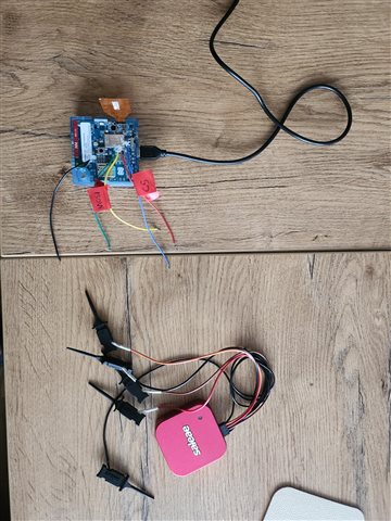

    The <err> ADXL372: failed to read id (0xAD:0x0) only happens when I got SPI wires connected to the logic analyzer. See image below:
    However, if I disconnect the logic analyzer as shown below:
    and reset the board, I will no longer get the error about adxl372.
    Could that be related that when I connect to the logic analyzer, CHIP select is pulled up and it does not fails to detect ADXL372 device? But it is quite strange why would it do that because in my code I dont have anything to do with ADXL372. Unless the zephyr automatically tries to detect whatever is defined in the device tree without any user code. Could that be the case?
    Anyways, my questions from the initial post remain unresolved. I hope to receive any clarifications. Thanks in advance!

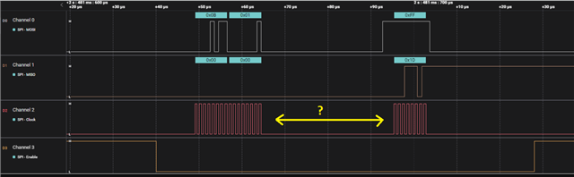

    I have been working on this for quite a while now. I honestly think I have tried almost everything I could at this point:
    1. I have tried to use seperate spi_write and spi_read functions
    2. I have tried to use spi_trasnceive function
    3. I have tried to manually control chip select line
    4. I have tried to use automatic chip select line control via spi_cs_control
    I have also tried to run accell_polling sample project just to confirm whether my HW is not damaged and it is working and it is. I am able to read the sensor data without any issue but I am not interested in that. I just want to learn about SPI and how to write my own low level drivers.

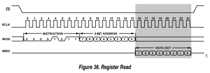

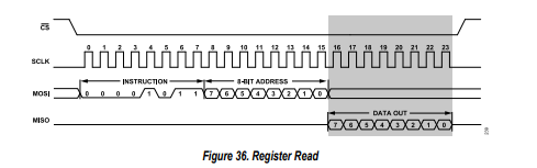

    //According to the ADXL362 datasheet (https://www.analog.com/media/en/technical-documentation/data-sheets/adxl362.pdf)
    //Figure 36, we follow multi byte structure where first byte is ADXL362_READ_REG and second byte is the register address

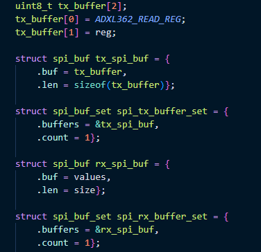

    static int readRegister(uint8_t reg, uint8_t *values, uint8_t size)
    	int err;
    	uint8_t tx_buffer[2];
    	tx_buffer[0] = ADXL362_READ_REG;
    	tx_buffer[1] = reg;
    	struct spi_buf tx_spi_buf = {
    		.buf = tx_buffer,
    		.len = sizeof(tx_buffer)};
    	struct spi_buf_set spi_tx_buffer_set = {
    		.buffers = &tx_spi_buf,
    		.count = 1};
    	struct spi_buf rx_spi_buf = {
    		.buf = values,
    		.len = size};
    	struct spi_buf_set spi_rx_buffer_set = {
    		.buffers = &rx_spi_buf,
    		.count = 1};
    	err = spi_transceive(adxl1362_sens, &spi_cfg, &spi_tx_buffer_set, &spi_rx_buffer_set);

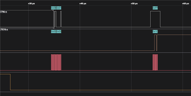

    I cannot wrap my head around why would the most simple spi_transceive would not work and why would I be getting error -134 when trying to request sensor ID.

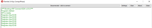

  • Thank you both for your answers. I still have not managed to get the SPI communication to work between nRF9160 on the Thingy91 and the ADXL362. Just to ensure the logic analyzer does not cause any issues as hmolesworth mentioned, I have disconnected it from the Thingy91 board (desoldered the wires)

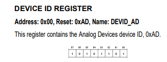

    I have been further analyzing the Thingy 91 and SPI. My goal is to be able to read the device ID as described in the ADXL362 datasheet: https://www.analog.com/media/en/technical-documentation/data-sheets/adxl362.pdf
    Method1
    This method uses spi_dt_spec and spi_transceive_dt methods
    The full source code:

    	printk("Program started \n");
    	if (spi_is_ready(&spec) == true)
    		printk("SPI is ready \n");
    	else
    		printk("SPI is not ready \n");
    	uint8_t values[1];
    	while (1)
    		int ret = readRegister(ADXL362_REG_DEVID_AD, values, 1);
    		if (ret == 0)
    			printk("Read chip ID failed \n");
    			k_msleep(1000);
    		else
    			printk("Register chip ID:%.2x\n", values[0]);
    			k_msleep(1000);
    	return 0;

    // According to the ADXL362 datasheet (https://www.analog.com/media/en/technical-documentation/data-sheets/adxl362.pdf)
    // Figure 36, we follow multi byte structure where first byte is ADXL362_READ_REG and second byte is the register address
    	int err;
    	tx_buffer[1] = reg;
    		.buf = tx_buffer,
    		.count = 1};
    		.buf = values,
    		.len = size};
    		.count = 1};

  • The same issue cam up just recently; the received data you are looking for is the 3rd byte not the first, and all 3 bytes have to be received.
    	uint8_t values[3]; <=== change
    	while (1)
    		int ret = readRegister(ADXL362_REG_DEVID_AD, values, 3);   <=== change
    		if (ret == 0)
    			k_msleep(1000);
    		else
    			printk("Register chip ID: %d\n", values[2]);   <=== change
    Edit: Here's a link to a similar case spi-receives-ff-each-time-miso-in-high-impedance
  • Thanks for response. I have wired up logic analyzer and run method1. See the waveforms below:
    The most obvious issue is that the MOSI line is not sending 2 bytes in a row. Instead, it sends 1 byte then does a 20uS pause before sending a new byte and that is obviously wrong according to the ADXL362 datasheet.
    After trying your suggestion, I am able to read the correct ID and the waveforms are as following:
    An alternative suggestion has been posted in the zephyr git regarding the same issue.
    https://github.com/zephyrproject-rtos/zephyr/issues/65512
    It has been suggested to replace:
    	 	.buf = values,
    	 	.len = size};
    	 	.count = 1};
    with
    	struct spi_buf rx_spi_buf[] = {
    		{.buf = NULL,
    		 .len = sizeof(tx_buffer)},
    		{.buf = values,
    		 .len = size}};
    		.buffers = rx_spi_buf,
    		.count = ARRAY_SIZE(rx_spi_buf)};
    for unknown reasons.
    The logic analyzer after applying suggested change:
    As you can see the above solution provides simillar results to your suggested method.
    Despite the fact that I am now able to read the correct data from the sensor device, I still have some questions:
    1. Why is there a gap after sending 2 bytes and receiving data? Is that expected?
    2. With your suggested solution, why do I need read 3 bytes instead of 1 byte? That does not make any sense to me at the moment... Since I have 2 seperate buffers (one for tx and one for rx) as described below:
    the RX and TX parts are seperated so I can choose however many bytes I want to send and however many I want to receive. Why would I need to read 3 bytes when only 1 byte is received?
    Is that something that only applies to this particular accelerometer? Or the same applies to other SPI sensors as well?
    Do you understand my confusion and what I mean?
