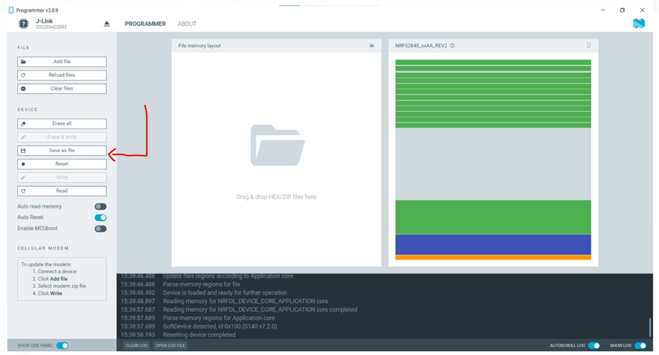

We have tried to download the HEX from the programmer application, using the button "SAVE AS FILE",  show the next screenshot.
with this procedure, we get the HEX MERGED, all in one file.
We can upload the HEX to the MCU fine. when we checked the block memory usage in the NEW MCU, it has the same pattern as the original MCU.

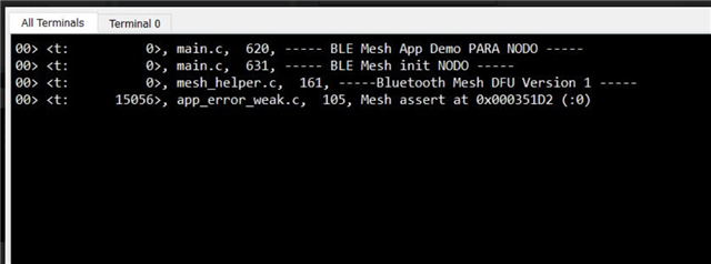

But when the MCU start send an error, I copied the error.
This is the Error when the firmware start.

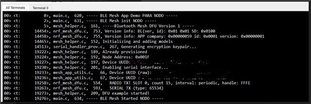

And here is how the node works with the original procedure (using nrfjprog )

    For merging files, you can use mergehex, which is part of nRF Command Line Tools.
    One reason why it may fail when using the method you are using, is that there may be some values in UICR which are not part of save file from the nRF Connect for Desktop Programmer App. Typically UICR is used for storing the bootloader address, metadata pages, etc. which is required for the operation of the device. You should therefore always use tools such as mergehex for merging hex files, and not rely on writing to and reading from a device.
