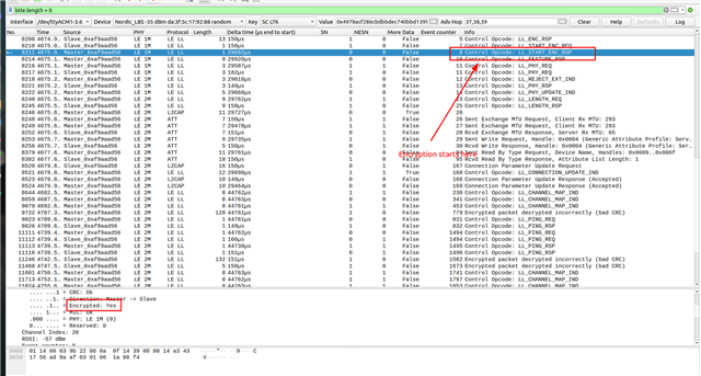

We try to sniff the discovery procedure using Wireshark and we are getting "Encrypted packet decrypted incorrectly (bad MIC)" error in the Wireshark logs.
We started the sniffer from the beginning itself that is, we are sniffing the board before pairing and even then, we are getting the above error message.

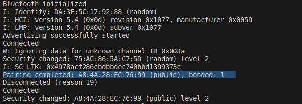

    The service is usually implemented on the iOS device, and the corresponding client implementation on the peripheral. Anyway, to decrypt the packets you need to insert the SC Private Key used for the connection. You can retrieve the key from the debug log if you build your project with CONFIG_BT_LOG_SNIFFER_INFO=y.

    I see the key in the debug log after enabling the macro you provided.
    <inf> bt_keys: SC LTK: 0xXXXXXXXXXXXXXXXXXXXXXXXXXXXXXXXX
    The thing is it is not static key, each time the key changes.
    Is there any kconfig param to use static key instead.
    Or how to decrypt in wireshark if this is the case. I see in the sniffing link you have provided does not have information on how to sniff pairing info if SC LTK key is used.

    7. Sniffer did not get the key during this stage and it shows error: "Encrypted packet decrypted incorrectly (bad MIC)"

    10. Copy and paste the key in the wireshark as mentioned.
    11. Connect iPhone and test notifications.
    12. Wireshark can decrypt all the packets.
    From the above test I was able to get only notification packet format.
    I did not get pairing packet exchange. Please let me know if I am doing anything wrong.

    I tested it here to make sure I was not missing anything and it turns out that CONFIG_BT_LOG_SNIFFER_INFO=y will actually print the Long Term Encryption Key (LTK), which is the key used for encryption, not the SC private key used to compute this key during the pairing exchange. With this LTK, the sniffer should be able to decrypt all connections with the given peer device.
    I am getting the SC LTK key in the debug log, and this is changing every time.
    The LTK should remain the same across connections if the devices were bonded. Does the log say "bonded: 1" when you perform the initial pairing as shown here:
  • Yes, I get "bonded: 1" in the initial pairing.
