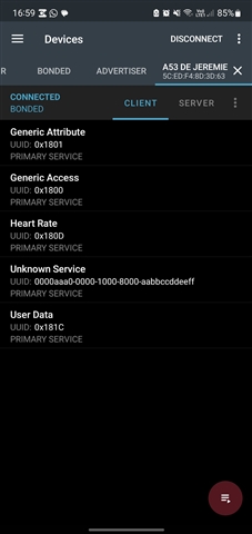

  • Hi!
    When I try to scan using bluetoothctl, my phone doesn't appear, and I have no way to pair.
    Is it only your phone you don't see? Do you see other devices advertise? Do you have any more logs of this?
  • I can see other devices like headphones, but not phones and computers.

  • Edit :
    That's my bad, I didn't realize that a special firmware was required.
    Correct, you need to flash the sniffer_nrf52840dk_nrf52840_4.1.1.hex firmware when using nRF52840-DK as sniffer
  • I tried to sniff the advertising of my phone, but it's not detectable. I applied the following filter: 'btle.advertising_address == 5c:ed:f4:8d:3d:63,' and there is no corresponding frame. I noticed something strange: when I start the sniffer with Wireshark, it works for 2 seconds and then stops, and nothing happens afterward.
    Not sure if it's Little-endian or Big-endian, maybe try the other way around as well. I have not seen this 2 second and then stops issue before.
    Another option, if you have a spare smartphone, you could also try to use nRF Connect for mobile app, and scan for the phone using the other phone, and see what kind of advertising info you get.
  • I finally managed to capture the advertising from my phone. The Bluetooth address indicated in the phone settings was apparently incorrect. I am sharing the link to the Wireshark capture with you.
    https://1drv.ms/u/c/6721ea87afaabc14/EZY5E3n7p8FBqXL5gCZSsKMBkw5mP_PmvM0KEfe8rxsNwA?e=yUwl26
  • Hi!
    You can zip and upload it here as well. I tried your link, but I got "Access denied"
