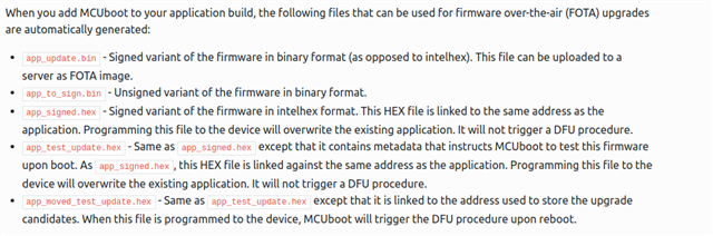

If I add
CONFIG_BOOTLOADER_MCUBOOT=y
CONFIG_NCS_SAMPLE_MCUMGR_BT_OTA_DFU=y
 to prj.conf in the peripheral_hr_coded example and build it six hex files are created
ap_moved_test_update.hex
app_signed.hex
ap_test_update.hex
mcuboot_primary.hex
mcuboot_primary_app.hex
merged.hex
zepjhyr.hex
There's nothing to indicate which of these are to be loaded.
There is also nothing I can see that tells you how to start the DFU udate from within an application.
In any case, thank you for your help.

  • The 'merged.hex'  is two bootloaders and the application - correct?
    If you are enabling MCUBoot (CONFIG_BOOTLOADER_MCUBOOT=y) and the nRF Secure Immutable Bootloader (CONFIG_SECURE_BOOT=y), then yes. However, most 52832 applications will only include MCUBoot as the only bootloader due to memory constrains.
    The build system in the nRF Connect SDK is far more advanced, allowing for the automation of the bootloader, application build, firmware signing, and other steps in a single build process. Whereas with the old SDK, you had to build the application and bootloader separately, and then manually sign the application and create firmware distribution packets using nrfutil.
    When I wanted a firmware update my application notified the boot loader to load the DFU application - which handled the Bluetooth transport, validation and installation of the update and then rebooted my (updated) application.
    The bootloader (MCUBoot) is still responsible for booting the application. They key difference now is that the FW updates are received by the application and not by the bootloader when you perform DFU over BLE. The bootloader will validate and activate by the update received by the application.
    The DFU service (SMP) to receive the FW updates is added automatically to the app when you build with CONFIG_NCS_SAMPLE_MCUMGR_BT_OTA_DFU=y
