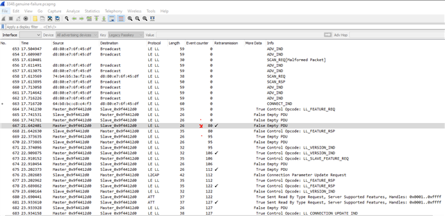

Slave BLE nRF52-based device often has long response delays to master
This is (hopefully) a more concise question than what was originally asked here.  When looking at nRF Sniffer captures while investigating that ticket, I discovered this problem which is likely causing a variety of issues.
My nRF52-based device frequently fails to respond to the master in a timely manner.  The issue is particularly bad when initially establishing a connection.  Here's an example:
663	17.716720	64:b8:bc:c8:c4:f3	d8:80:e7:6f:45:df	LE LL	60	CONNECT_IND
664	17.741230	Master_0x9f4412d0	Slave_0x9f4412d0	LE LL	35	Control Opcode: LL_FEATURE_REQ
665	17.741531	Slave_0x9f4412d0	Master_0x9f4412d0	LE LL	26	Empty PDU
666	17.741761	Master_0x9f4412d0	Slave_0x9f4412d0	LE LL	26	Empty PDU
...Device fails to reply...
667	21.642401	Master_0x9f4412d0	Slave_0x9f4412d0	LE LL	26	Empty PDU
668	21.642630	Slave_0x9f4412d0	Master_0x9f4412d0	LE LL	35	Control Opcode: LL_FEATURE_RSP <-- 3.9s to reply!
...Device fails to reply (Frame 667)...
669	22.373635	Master_0x9f4412d0	Slave_0x9f4412d0	LE LL	26	Empty PDU
670	22.373865	Slave_0x9f4412d0	Master_0x9f4412d0	LE LL	26	Empty PDU
671	22.374096	Master_0x9f4412d0	Slave_0x9f4412d0	LE LL	32	Control Opcode: LL_VERSION_IND
672	22.909875	Master_0x9f4412d0	Slave_0x9f4412d0	LE LL	32	Control Opcode: LL_VERSION_IND <--REPEATED
673	22.910152	Slave_0x9f4412d0	Master_0x9f4412d0	LE LL	35	Control Opcode: LL_SLAVE_FEATURE_REQ
674	22.910454	Master_0x9f4412d0	Slave_0x9f4412d0	LE LL	26	Empty PDU
675	23.202373	Master_0x9f4412d0	Slave_0x9f4412d0	LE LL	26	Empty PDU
676	23.202603	Slave_0x9f4412d0	Master_0x9f4412d0	L2CAP	42	Connection Parameter Update Request
677	23.202962	Master_0x9f4412d0	Slave_0x9f4412d0	LE LL	35	Control Opcode: LL_FEATURE_RSP
678	23.689862	Master_0x9f4412d0	Slave_0x9f4412d0	LE LL	35	Control Opcode: LL_FEATURE_RSP <--REPEATED
679	23.690164	Slave_0x9f4412d0	Master_0x9f4412d0	LE LL	32	Control Opcode: LL_VERSION_IND
680	23.690441	Master_0x9f4412d0	Slave_0x9f4412d0	ATT	37	Sent Read By Type Request, Server Supported Features, Handles: 0x0001..0xffff
681	23.933610	Master_0x9f4412d0	Slave_0x9f4412d0	ATT	37	Sent Read By Type Request, Server Supported Features, Handles: 0x0001..0xffff <--REPEATED
682	23.933928	Slave_0x9f4412d0	Master_0x9f4412d0	LE LL	26	Empty PDU
683	23.934158	Master_0x9f4412d0	Slave_0x9f4412d0	LE LL	38	Control Opcode: LL_CONNECTION_UPDATE_IND
...Device fails to reply...Or does that Opcode indicate disconnect?
684	26.915261	d8:80:e7:6f:45:df	Broadcast	LE LL	59	ADV_IND
685	26.915743	71:92:a0:33:a0:34	Broadcast	LE LL	63	ADV_NONCONN_IND
The master indicates a 5000 ms timeout which is frequently violated.  Connection usually fails 1 of every 5 times because of the timing issues. This capture is actually a failure even though the 5 second timeout isn't violated (possibly something app side on the connecting device doesn't tolerate the delays well).  Here's one with a clear 5 seconds before disconnect:

To make sure my app isn't hanging I added a bunch of debug lines to my main loop - As far as I can tell my app itself doesn't hang and that sleep is usually active for about ~250 ms of the 500 ms loop so there should be sufficient resources for the BLE stack to respond.  There are many print lines during the gaps in time my device doesn't respond.
Here is the exact commit used to generate the Wireshark capture and RTT output logs below.

  • 3348.genuine-failure.pcapng
  • 8228.badConnect-fresh-with-console-2.pcapng

  1. For every master 'Empty PDU' - There should be a slave response, right? Mine often does not respond.
  2. Several requests seem to take very long, although still actually go out (ex - LL_FEATURE_RSP) - What could cause such a delay?  Is there a queue length I can watch?
  3. Could this be a priority issue of the BLE stack?  My app is very resource intensive (particularly LVGL / display libraries) and the calls to update the LCD screen can take 300 ms. I wonder if this is allowing the BLE stack to 'fall behind' and maybe build some queue of messages? It's not clear how Zephyr prioritizes the app code with the BLE stack.
  4. Could this be a signal/noise issue and possibly my device just isn't receiving those messages?

    The master sends an empty PDU to maintain the Bluetooth connection when the application has no data to send. The slave would do the same time, but it doesn't have to respond to each one from the master.
    As for your sniffer logs, we see there is something very strange with this Android 12 tablet.
    There are a lot of missing packets in the sniffer trace. The event counter goes from 0 to 80, then 80 to 95. So the sniffer is not picking up these packets. Either the master is not sending these packets at all, or it's sending them at totally the wrong time or frequency/channel. Could you test with a different tablet/phone?

    • I only see a jump in the event counter when there are large gaps in time and a response is pending on my device. In your example - LL_FEATURE_RSP takes 3.9s to respond. I wonder if the Bluetooth stack is hanging until it sees that empty PDU?
    • You can see the same behavior in 'badConnect-fresh-with-console.pcapng' packet 5231 at 36.268s
    • Also in 'badConnect-fresh-with-console.pcapng' - It times out at 47.347s and we start broadcasting again - but we never receive the CONNECT_IND_TERMINATE
    • RSSI is -48 dBm master->slave and -60 dBm slave->master - Doesn't seem bad enough to explain ~5s gaps in communication
