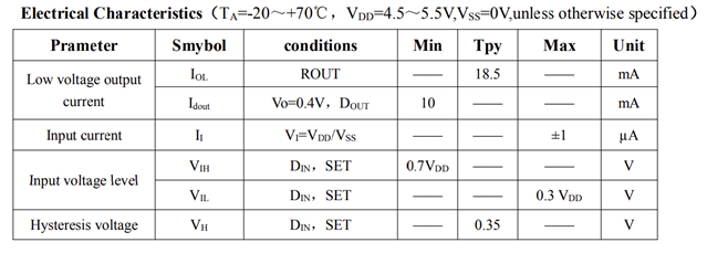

I am trying to develop a circuit to control three addressable LEDs. I am using nRF52840 to do so, which is its power level is 3.3DCV. The supplied power to the LEDs is coming from external 5DCV power supply.
With that being said, the LEDs are dimmer when the signal is coming from the nRF52840 compared to the one coming from arduino UNO for example.
Can you give me any insights what is the reason for this issue and how to get it solved?
I am using this WS2812 Sample Application from Zephyr.
