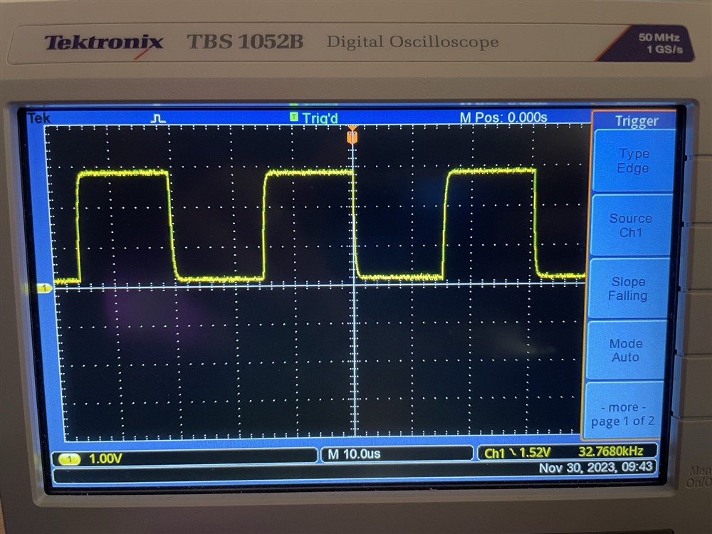

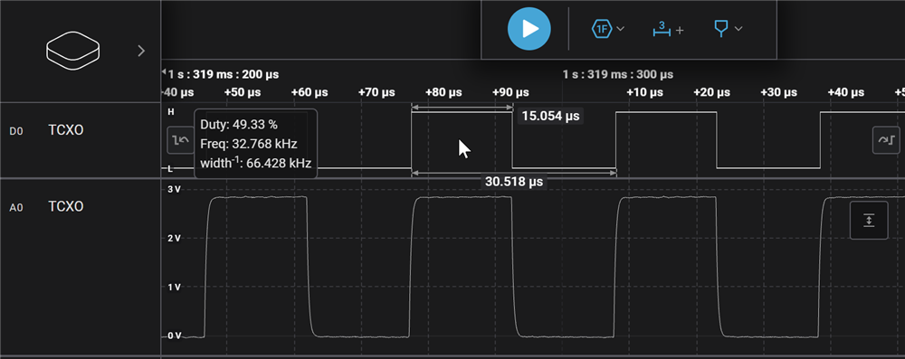

    Can you provide details of the TCXO and an accurate scope (not logic analyser) trace of the TCXO waveform at the nRF52?
    Thanks for your replies, and my apologies--I've updated the original post with more detail about the part. It's SIT1552AI-JE-DCC-32.768E, specifically chosen for the rail-to-rail full swing and extra high accuracy. We have not requested or configured a non-standard VOH/VOL value, so my understanding (and intent, and measurement) is that it's simply GND to VCC. Note, VCC in this circuit is 3.1V.
    The TCXO clock output is connected to P0.00 (XL1) through a 1K series resistor. (The signal appears to be the same on both sides of this resistor). P0.01 (XL2) is left floating. The LFCLKSRC register is configured at the top of the bootloader's main() function to full-swing mode (EXTERNAL + BYPASS bits as defined in nrf_clock.h):

    The bench tools I currently have available are a Saleae Logic Pro 16 (digital + analog) and a Tektronix TBS 1052B digital oscilloscope, neither of which is the world's best clock measurement tool, but here's what I get:
    Both devices show basically what I expect to see, though the rails aren't quite touched according to the Tektronix scope--just close. There is also a fairly large variance in what the Saleae shows for the actual clock period. The screenshot highlights a detected frequency that is exactly correct, but the analyzer reports a range of 32688 up to 32860 Hz. I suspect a measurement issue rather than a signal issue because (1) the Tektronix unit is much more stable and (2) one of our devices that works fine with a stable connection yields the same varied measurement on the Saleae device.
    If there is a specific tool I need to capture this better, let me know; I might be able to get one.

  • Looks correct; however I would try shorting out the 1k0 series resistor and see if there is any change. A periodic check in the firmware for the contents of LFCLKSRCCOPY and LFCLKSRC and LFCLKRUN would also be a good idea ..
    .. I should add that with a 1k0 resistor the high-impedance nRF52840 clock input pin will experience more interference from a high-speed clock source such as SPI ..
    Edit: I looked at the BMD340 and the SCK and Osc pins are pretty close together, plus the P1.15 SCK is unsuitable for any kind of SPI clock; it is close to the radio and will affect as well as be affected by transmissions. So .. the fix - if shorting the 1k doesn't work - may well be to use an unrestricted P0.nn i/o pin for SCK (and probably MOSI and MISO as well).
