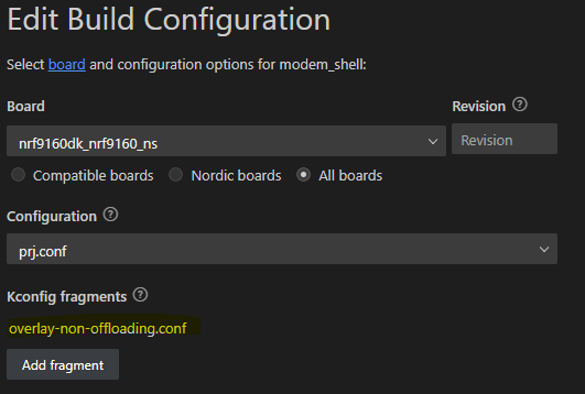

I would like to measure some basic parameters using Thingy:91.  Modem shell (MoSh) provides all the necessary tools. However, I was not able to build an image with iperf ( egion `FLASH' overflowed by 868 bytes) . Do I understand correctly that there is no other way to create such image when developing using USB flash ?

    How do you build the Modem Shell sample? How do you modify the sample?
    In the Modem Shell sample, it already enables Iperf3 by CONFIG_MOSH_IPERF3=y

    I've modified prj.conf
    CONFIG_MOSH_SOCK=n
    CONFIG_MOSH_PING=n
    CONFIG_MOSH_CURL=n
    CONFIG_MOSH_LINK=y
    CONFIG_MOSH_SMS=n
    CONFIG_MOSH_GNSS=n
    CONFIG_MOSH_LOCATION=n
    and build failed with error
    region `FLASH' overflowed by 868 bytes

    Forget overlay-non-offloading.conf. Try to modify prj.conf with
    CONFIG_MOSH_SOCK=n
    CONFIG_MOSH_PING=n
    CONFIG_MOSH_CURL=n
    CONFIG_MOSH_LINK=y
    CONFIG_MOSH_SMS=n
    CONFIG_MOSH_GNSS=n
    CONFIG_MOSH_CLOUD_REST=n
    CONFIG_MOSH_AT_CMD_MODE=n
    CONFIG_MOSH_STARTUP_CMDS=y # This is needed by iperf3
    This set seems to compile for me and ~30kB (10%) free flash.
