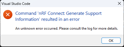

I get an error when I Open Command Palette in VS Code and use the command nRF Connect: Generate Support Information:
Command 'nrf Connect: Generate Support Information' resulted in an error
An unknown error occurred. Please consult the log for more details.
I don't know where to find the log referred to.
