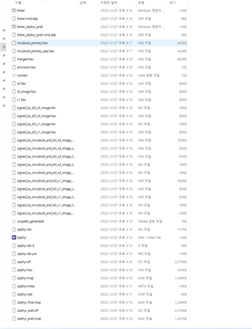

    I managed to build s1 image for upgrade.
    I modified prj.conf in ncs/v2.5.0/nrf/samples/bootloader, but I didn't set this path by myself.
    So, my question is as follow.
    1. How can I modify s1 image configuration file path?
    2. What is the B0, S0, S1 Image(Its meaning)
    3. Which image can be used as upgrade image? I got lots of hex files.(Plz see below image)
    I would not suggest you modify prj.conf of ncs/v2.5.0/nrf/samples/bootloader directly. You can add the NSIB as a child image to your application by enabling CONFIG_SECURE_BOOT=y. Here is an command example.
    When adding the NSIB as a child image by enabling CONFIG_SECURE_BOOT=y, you can create child_image\create b0.conf under the application to overwrite the configuration.
    B0 is nRF Secure Immutable Bootloader (NSIB). S0 and S1 are updateable MCUboot. See https://developer.nordicsemi.com/nRF_Connect_SDK/doc/2.5.0/nrf/samples/bootloader/README.html#pre-signed-variants
    We have https://developer.nordicsemi.com/nRF_Connect_SDK/doc/2.5.0/nrf/config_and_build/config_and_build_system.html#output-build-files which describes signed_by_mcuboot_and_b0_s0_image_update, which is the image you will want to use. Also, see this post.
    jswcomkr said:
    4. Finally, How can I set the start / end address of each image? I want to use MCUboot-Primary Slot-Secondary Slot structrue.
    It would be handled by partition manager which would be enabled automatically with muti-build.
    jswcomkr said:
    5. I want to design my MCU's partition as follow:(pm_static.yml in project folder)
    Remove the pm_static.yml. Let the partition manager handle it for you.
    jswcomkr said:
    My intend is that s0 is primary slot, s1 is secondary slot for new firmware, and mcuboot is for bootloader.
    S0 and S1 are for updating the mcuboot instead of app.  See https://developer.nordicsemi.com/nRF_Connect_SDK/doc/2.5.0/nrf/samples/bootloader/README.html#pre-signed-variants
    jswcomkr said:
    As you know, nRF52832 has 512KB internal flashes, so I divided it in 3 pieces. but it is not work.
    Do you want to update mcuboot or just the app?
    If you just want to update the app image, you can just enable the DFU as my colleague suggested in this post. Then, the memory layout would look like this
