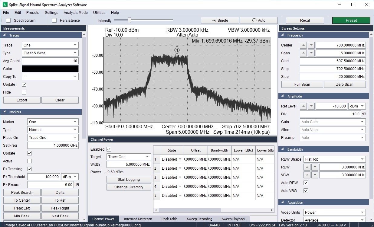

Setup:
I am doing a conducted test with the nrf9160 connected directly to a Signal Hound SA44B spectrum analyzer.
I have a dc block and 30dB attenuators installed to protect the spectrum analyzer.

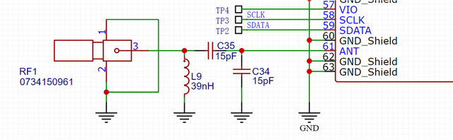

Pin 61 is using the same components as the nrf9160 Feather design
Test:
Command I'm using to test max power is:
AT%XRFTEST=1,1,12,7000,23,1,1,6,0,0,3,3,0
Command I'm using to test a lower power level is:
AT%XRFTEST=1,1,12,7000,10,1,1,6,0,0,3,3,0

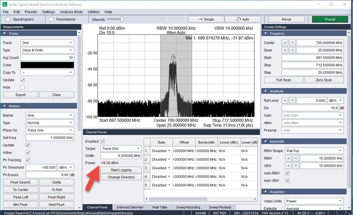

For the max power test the nrf9160 is returning 276/16 = 17.25dBm
Here is my spectrum analyzer screenshot of the test measuring -19.39dBm
Questions:
1. Why isn't nrf9160 returning a transmit value for the max power 23dBm as expected by the command?
2. I have done several different tests with/without attenuators to try figure out why my spectrum analyzer is reading about 6dBm lower than the nrf9160 is telling me on B12.  Why is my spectrum analyzer reading 6dBm lower than the nrf9160 response value?  On some other bands it is even 10 to 20dBm difference.
2. I see the nrf9160DK is using different components and topology on pin 61 for the antenna so which reference design is the best one to follow?

  • Hi, Gary!
    Before we begin a proper investigation on the issue, could you try to remove the matching components between the ANT pin and the connector (remove L9 and C34, short C35)? As both are supposed to already be matched to 50 ohms.
    Mathias
  • Mathias, thank you for a quick response.  I have done the test and the results are very encouraging!!
    Same test setup as OP
    L9 and C34 removed and C35 shorted
    so now it's just a 4 Layer PCB trace designed with 50Ohm impedance
    nrf9160 response: 154/16 = 9.625dBm
    Spectrum analyzer: 9.5dBm
    nrf9160 response: 328/16 = 20.5dBm
    Spectrum analyzer: 20.41dBm
    So I'm very happy to see my PCB impedance design is basically perfect.
    I also tested B5 and B2 with same results

    So my biggest question now is this all I need for production and will this pass compliance when we get to that stage or do I still need some matching components on pin 61?  What does Nordic recommend as best practices for a reference design because I'm seeing huge variations from one reference design to the next.

    Ideally, you shouldn't need any matching components, as both parts already are supposed to be 50 ohms. However, theory and practice might deviate from each other and thus, making the inclusion of matching components favorable. I will have to double-check with some of my colleagues to hear if it would be wise of you, based on prior experience, to spend time on finding and creating a matching network and if this would be able to bring you closer to an output power of 23 dBm.
    This matching network is for the antenna only and will vary between antennas, layouts, casings, etc.
