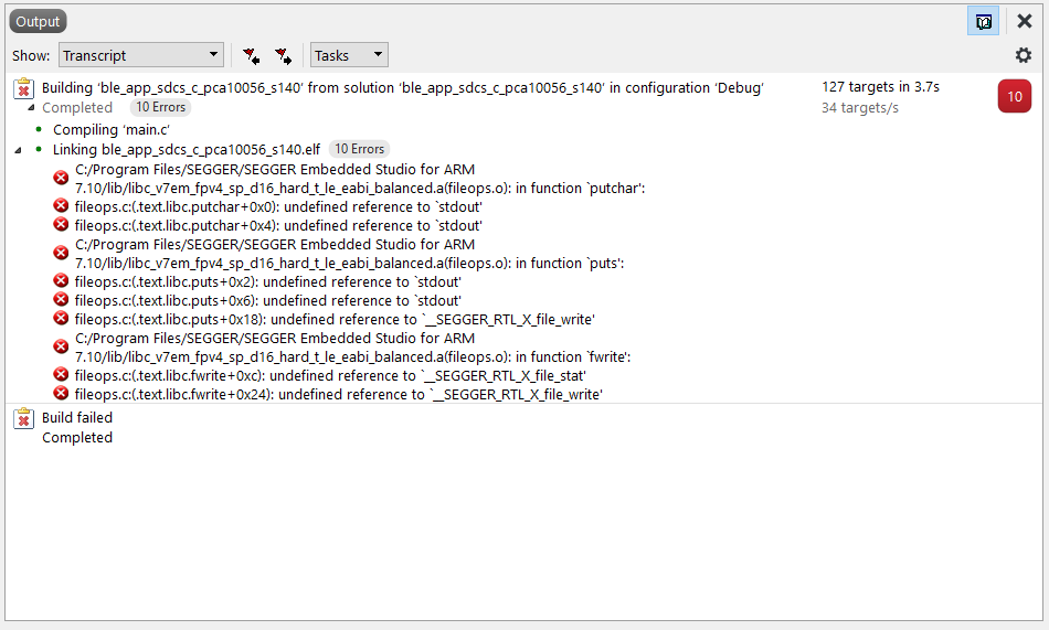

Because I use the logging module and the uart module from the example program, I got an error in the initialization. I prevent that error from happening by disabling UART for the logging module (NRF_LOG_BACKEND_UART_ENABLED 0 in sdk_config.h). Now the logger is only using RTT.

  • Ok... From the error-log I guessed that I have to set up retargeting in a correct way.
    Because of that I checked the retarget.c and sdk_config.h of the peripheral/uart example solution and copied these lines into the sdk_config.h of my own project:

    Then I tried to rebuild the solution and still got linker errors. I did a bit more research and found this topic:
    https://devzone.nordicsemi.com/f/nordic-q-a/88123/build-environment-problem/370762
    From what I remember I recently had to install SEGGER Embedded Studio for ARM 5.42a to build the peripheral/uart example. I then tried to build my current project with SEGGER Embedded Studio for ARM 5.42a instead of 7.10.
    With that older version I was able to build my current project without errors. I will debug and continue on friday.
