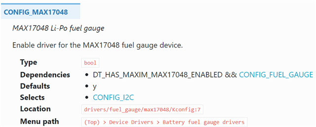

2. If I want to use the driver 'zephyr/drivers/fuel_gauge/max17048', what configuration should be enabled in prj.conf? I see there is below in the documentation:
         But in the sample, it only config 'CONFIG_FUEL_GAUGE=y' in prj.conf.

    1&2. Yes the sample uses the driver.
        To select the correct driver for your HW you need to include the MAX17048 device in your overlay.
        The correct driver will be picked up automatically.
