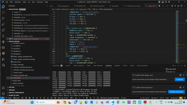

  • Hi Einar,
    I saw this in the Zephyr.dts file in the project
    I changed it to 0x26 and 0x27 but it made no difference.
    I also tried your suggestion about but it still shows no device connected

    and I made changes to the Zephyr Projects.dts files to this below and it still did not work...
    i2c0: arduino_i2c: i2c@40003000 {
                #address-cells = < 0x1 >;
                #size-cells = < 0x0 >;
                reg = < 0x40003000 0x1000 >;
                clock-frequency = < 0x186a0 >;
                interrupts = < 0x3 0x1 >;
                status = "okay";
                label = "I2C_0";
                compatible = "nordic,nrf-twi";
                sda-pin = < 0x26 >;
                scl-pin = < 0x27 >;
    I am not aware of a Projects.dts file, but your overlay file looks outdated. Which nRF Connect SDK version are you using? As mentionned, pin control is used in version 2.0.0 and higher, so you should refer to the samples mentionned (or other examples of I2C in the SDK). There is also a good introduction in Lesson 6 – Serial communication (I2C) in the nRF Connect SDK Fundamentals course.
