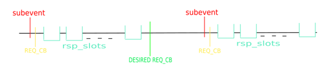

0. First and foremost, I'd like to understand struct bt_le_ext_adv_cb a bit better. It seems to me like pawr_data_request is sent to the upper code layers as soon as a subevent is transmitted, and it's always asking for a single subevent worth of data? What I'd like is to receive it after all the response slots are through. So that my broadcaster has the time to receive all the answers, and based on them, decide what the next subevent should send!

    However, you haven't answered my question number 0. Below is a sketch that explains it. I want to be able to set subevent data after rsp_slots, for the next subevent. But it seems that as soon as the subevent is sent, the data for the next subevent is requested. Is there a way to work around this?
    I'd also like to know what's the maximum number of octets that a broadcaster can transmit for a single subevent. I was able to transmit around 70-80 octets.

    The timing of the data request callback is not really deterministic because of the delays in the system. So this is not something we can guarantee. The specification only states that the request shall be generated when there are buffers available, and there are no restrictions for timing.
    The number of subevents it requests data for can be configured with the BT_CTLR_SDC_PERIODIC_ADV_RSP_TX_BUFFER_COUNT config, and if you want to know if/when no response is received, you can enable the BT_CTLR_SDC_PERIODIC_ADV_RSP_RX_FAILURE_REPORTING to generate a response report event with Data_status = 0xFF according to "7.7.65.37 LE Periodic Advertising Response Report event" from the Bluetooth spec. That way the application can know when the time has passed all response slots. Meaning the application can count response reports before sending the data for the next subevent.
    Even though ESL restricts payload to 48 bytes, it does not count EAD data for example. So it is a bit bigger than 48 for the ESL use case.
    PAwR supports 249 bytes payloads which can be configured with this config: https://github.com/nrfconnect/sdk-nrf/blob/main/subsys/bluetooth/controller/Kconfig#L433
