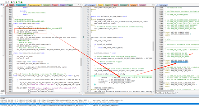

Another experiment was done today, if Bluetooth sends data (calling ble_nus_data_send function) timer240us into an interrupt is not accurate. If only the Bluetooth connection is successful and no data is sent, 40us is accurate. This is also a problem with other timers.Could you please help me find out what the reason is?
Please help resolve these problems, thanks!
